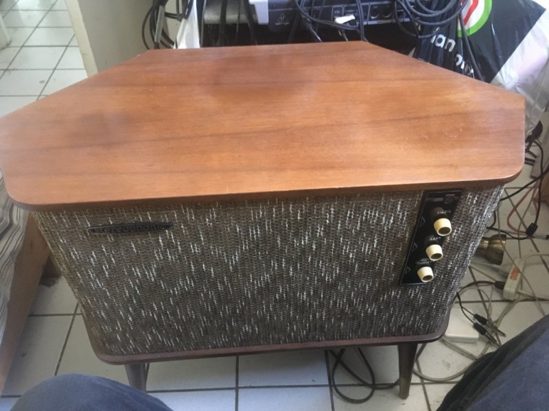

Wow ! What a lovely piece of Philips audio history. Great to see/hear it's working ! Having had a few Philips gems, the 800 Ohm speaker voice coil requires quite a large number of wire coil turns...That means the coil is thicker than a usual low impedance speaker. So, if you "push" the amp/speaker, it is easier to cause voice coil rub. Low to medium level listening is in order. Please do not try and blast it, as it will blast fast...
Within the amp, the coupling caps should probably be freshened/upgraded. The caps going into the 6CW5/EL86 tubes cannot leak any DC, or damage will be passed onto the speaker. If you hear any fuzzy sound, it's time for some cap replacement. I have not checked the schematic yet...Is there a coupling cap from the EL86 to the speaker ? If so, that is another cap to ascertain is a good one. Coupling caps pass the signal (considered AC) and block DC. Even passing .3V DC can shorten tube or speaker life. That is a great collector's item ! Enjoy !

I had my vintage electronics guy check all the tubes and replace every cap.

My electronics guy replaced all the caps for $50. He's semi-retired and I'm pretty sure he's undercharging me... but that should give you an idea of what to expect.
He also plugged in an electric guitar to give me a short demonstration as a warning about the fact that this is a high-impedance system. He turned it on a turned the volume up and strummed a chord... it wasn't overly loud. He then turned amp off (to protect it) and he unplugged the jack from the guitar. He turned the amp back on but left the volume low and simply touched the end of the jack with his finger. Even though the volume was low, this produced a disproportionately loud buzz.
Long story short, he advised me to be careful with what I plug into this amp as it would be easy to blow the speakers.
This same thing will happen with any audio or guitar amplifier. Just make sure the volume is all the way down or the unit is off when switching cables and there will be no loud surprises.
