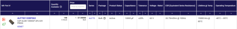

Hello all,
Started a 2275 recap and found that the main caps called out in this list are obsolete. Anyone know of an alternate?
I looked around, but came up short.
Any help would be appreciated.
J.T.
Mouser has these in stock:
Digikey has these in stock:
Measure the diameter and height of the existing caps and compare with the specs above. Are the original ones screw terminal or solder?
Thanks for the help Dankik. I learned how to use the alternate product search and came up with PN 661-6D750MLN183TC79U. It is a screw type, but it should work well. It is 50.8mm x 79mm tall. The originals are 50mm X 70 tall solder type. I have enough room under the cover that the 79mm height will fit. They are the same uf and voltage rating as the replacements called out in the list. We shall see how they work. Thanks again for the assistance.:beerchug:
