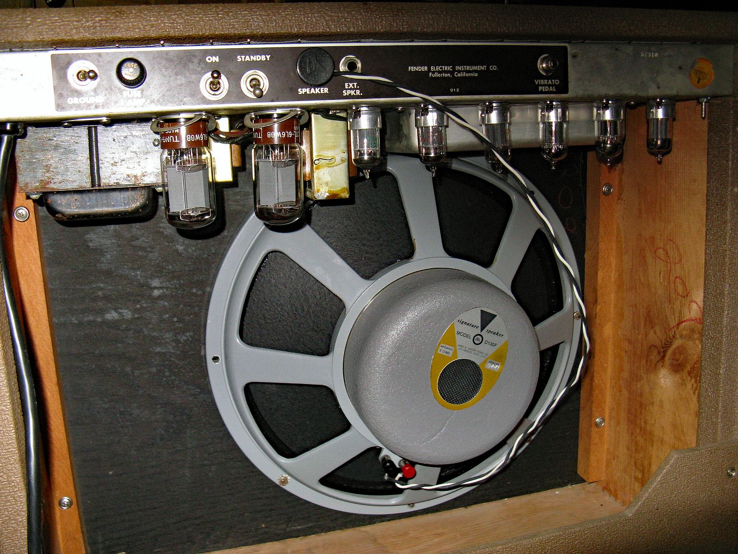

I treat the TungSol (USA) 5881/6L6WGB max at 23 watts/tube. Class AB1, push-pull. Maybe it's conservative? Dunno. But, in the few amps I used 5881s, the Tungsols last forever — sometimes even longer than the 12AX7 (which some amps push hard).
My 1962 Pro has been one of my most reliable amps (knock on my wooden head). :thumbsup:

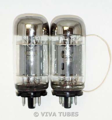

But what does a 6L6GC look like? The ones Langerex is selling looks like the 6P3S-E
This website claims the 6P3S-E is a direct equivalent of the 6L6GC,
They aren't really, but seem to hold up fine for some folks. It probably depends on the amp design and voltages used.
They're closer to the 5881 from what I've read so far.
Langrex is lying. They have relabeled the 6P3S-E with 6L6GC nomenclature. The 6P3S-E is good for about 25W anode dissipation maximum. I have tested them, and there's where they begin to show color. The 6L6GC is a 30W tube.
VIVA has been making those deceptive claims for years. They include a disclaimer in their eBay sales in an attempt to evade responsibility. They even show the little 19W 6P3S to be equivalent. This is total fiction.
