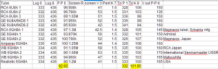

So I know this has come up a bunch, but for unrealated reasons I had knocked together a test fixture using Dynaco Mark IV schematics and figured this might be a useful place to drop some data about how these actually perform. Something I maybe should have done but did not was see what the output was without changing the screen resistor. My values were determined by adjusting the screen resistor to get max symmetrical output at the cathode of the inverter section.
so for starters, this is the Mark IV schematic.
Changes to this just for completeness
The stuff in the red box is not there since this isn't a complete amplifier.
The 270K resistors go to ground, not to a negative bias supply.
The 620 + 47 resistors in the cathode chain have been replaced with a single 680 ohm resistor.
The highlighted 1.5M screen resistor has been replaced with a 470K + 1M pot.
The 82pf + 18K shelf network is not installed.
None of those changes should affect the results in a meaningful way but I'm trying to be transparent here.
Here are the results. Not sure it means a ton, but the screen resistor value to get max output is quite different, ranging from 780K to 1.3M. Values either side of optimal produce clipping or visible distortion on one side of the waveform and overall less output.
Voltage output is peak to peak measured to ground. Grid to grid would be double this. An ST-70 or Mark IV needs about 70 volts grid to grid, the worst tube here is capable of 270 volts so there is a huge amount of headroom which makes this not completely critical. Fair guess if you stick a 1M in there, it'll work well enough with most tubes.
Just as a mention though, GE#2, the one that wants the smallest screen resistor, when set to 1.5M the best I can get out of it with no visible waveform distortion is about 10v p-p, which is well below the point that is needed for max clean output in this circuit. Beyond that it has an overly fat shape to the negative peak, so some tubes are absolutely not going to play nice with stock values here. At 1M this tube will do 100v p-p which is plenty
If you want to get it closer to optimized without actually bothering to measure per-tube, subbing the 1.5M for a resistor + pot arrangement and adjusting it to get 332 volts at pin 1 would likely get you there. 332v is just the average of all voltages in my little selection here, but its also the value with the least variation % wise.
Voltages at lugs 6 and 8 were determined by working backwards from the voltage chart in the Mark IV manual. Power supplied from a Heathkit PS-2 to lug 8, and a 47K dropping resistor to a 22uF cap for pin 6, also duplicating the Mark IV circuit.
highlighted values are the averages. Not sure they are all that significant but here you go.
WB just means White Box. Sorting is more about the box than whats in the box. Last column is any other details.
Unrelated to anything, I did find that the Japan tubes are both prone to some 60hz hum which is extremely bad if the heater supply is left completely floating. Not sure how these would behave in the amp.

I suppose I could collect that but I'd have to decide on some signal level as a standard. Also I don't have any 7199 as a reference so it wouldn't be a complete comparison. Likely it would have to be measured at the triode cathode for meter loading reasons.
Might be interesting to see if the point of peak swing is also the point of best distortion. Just visually i can say it has an effect on the output waveform, though how much of that is because of bias on the triode and how much is the pentode I don't know. I assume its more to do with the triode though

Anecdotal evidence, but I can't tell a difference between an RCA 6GH8A with a socket adapter and an RCA 7199 on the SCA-35 where I did a good amount of listening tests. Obviously some differences electrically, even distortion and such that can be measured, but the end result in my experience was they sounded exactly the same. I think anyone would be hard pressed to tell them apart in a blind test.
Which is confirmed in my previous measurments. The SCA35 has stabilized pentod idle point by feedback thus makes the circuit insensitive to tube parameters. The concertina part is by design also insensitive to tube properties as long as it's grid is
at a suitable voltage.
It fixes the DC part of the equation but it adds an AC complexity. The SCA35 has some positive feedback through that connection which can cause problems with some tubes. @dcgillespie did a deep dive on it in his sca35 thread and i don't recall the fine points but something about oscillation problems under certain conditions.
Could possibly partially implement it but with a bypass cap to kill the AC portion of the feedback. Maybe some evening I'll play with that. Currently digesting too much breakfast then I need to go wash and wax the car. Too nice to be sitting inside at the bench fooling with phase splitters for an amp I don't own.
