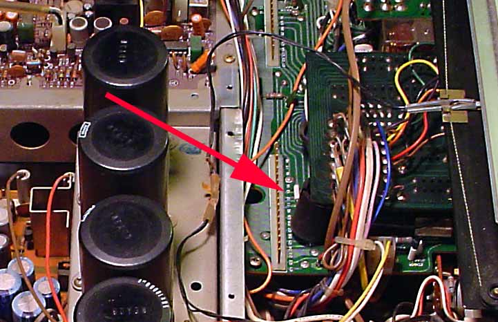

I'd try switching to one of the dead modes and bending the dolby board a bit ... carefully! Just pull up on a corner and press the board with a pencil eraser in a few spots. Old school trick to track down an intermittent solder connection, which would be typical of the pass throughs on that board. Worked on old TV sets anyway ...
Not to mention old Sansui's ... imagine my surprise when I went digging into a "professionally restored" 9001 and found this.
Old receiver foot, jammed in between the boards, doing exactly what I mentioned earlier and giving the cold solder a wedgie ... <G>
PS ... if it IS the dolby board, you MIGHT be able to get away with retouching the pass throughs with fresh solder, but ... luck wit dat, eh. Only real way to guarantee results is to pull the board, pin it, and be done with it. Your call there ... do it right, and do it once.
