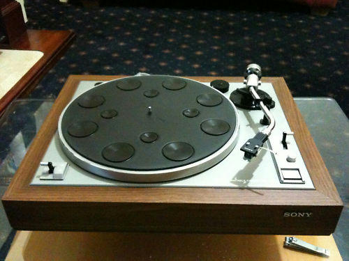

I tried various mats without a satisfactory result, it seems the 'P'-mount Grado/8MZ stylus is just not a good choice for this TT. Perhaps a hard-mounted standard Grado body on a spacer plate might work better but I haven't tried that, yet. Putting back the Digi 200 E 'P'-mount restored the 'magic' this TT can offer, and then some mat-swapping yielded interesting results as sampling Fleetwood Mac "RUMOURS" showed. The stock mat sounded fine as did the Technics mat, the felt and felt-cork mats didn't sound promising with static resonance testing and so didn't get a try. The best & cleanest sounding result came with an oddball Sony 'Planetary' type soft mat like this;
I do not have the Sony TT for this mat as it came with my freebie PS-X70, now reunited with the OEM mat.
