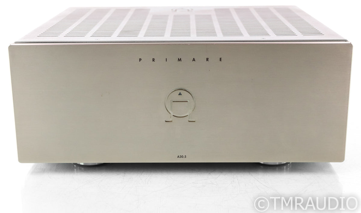

primare 30.5 five channel amp made in sweden. pile of "spoiler alert" sitting on left side of the photo.
chassis could have been a better design, rear panel not removable. cheap plastic rca-inputs are delicate, ended up installing chassis mount inputs. three of five toroids in the photo, other two set outside of chassis to make it possible to remove main board assembly. not an easy to service design and thats before we look at the smt/smd areas.

system initially came in for a low cost inspection and assessment due to a channel or two being down. after replacing a fuse and reinstalling a toroid output wire harness removed by a previous owner things progressed into the testing stage. most of the dc offset servo's were reasonably capable but that deteriorated quickly soon after, when the amp went home and the new/current owner starting exercising some hours on it.
amp came back to the shop for a revised inspection and possible upgrade options (modz to the max, is it worth it type of thing). the upcoming photos and analysis will shine some light on what was found and the final outcome i.e. design flaws and all plus soic-8 surgery.

removing surface mount op-amp servo chip, mc1458 and its unique specifications. one of five channels shown above, ch-2 specifically. which happens to be labeled u2, sunday comes to mind for some odd reason.
Screenshot 2026-04-10 at 08-59-39 High-performance dual operational amplifier - en.CD00000472....png
Screenshot 2026-04-10 at 09-00-12 High-performance dual operational amplifier - en.CD00000472....png
*supply voltage (max) and operating temp for the mc1458dt is the starting point. upcoming thermals will show a design flaw, hint: 70c/158f. when shopping around, how many op-amps have a +/- 22v voltage rating? the slew rate is nothing special (0.8v/us) although chances are it doesnt need to be. further testing/experiments might shed some light either way, hello circuit sim.
the mc1458idt was selected as replacement for all five channels, for obvious reasons. there are some surface mount zener diodes that feed the +/- chip supply which reduces 53v down to 21-22v. the zeners should have been a couple volts higher so that a higher grade op-amp could be universally dropped-in or something. rail-to-rail chips do exist and can provide 18v of offset.
when the channels were slowly flaking out due to heat/ageing into retirement, the unloaded outputs were showing 5v (chip issue) or -16v (+reg issue) of offset (volts, not milli-volts). when loaded with dim bulb active the output protection relay would start to toggle on and off e.g. circuit issue detected.
root cause for ch-2 appeared to be a weak +voltage regulator, unloaded it could barely do 4v. after researching the op-amps it is no surprise that ch-4 was flaking out and the regulator was fine. these are just the tip of the iceberg points of interest regarding this amp...
