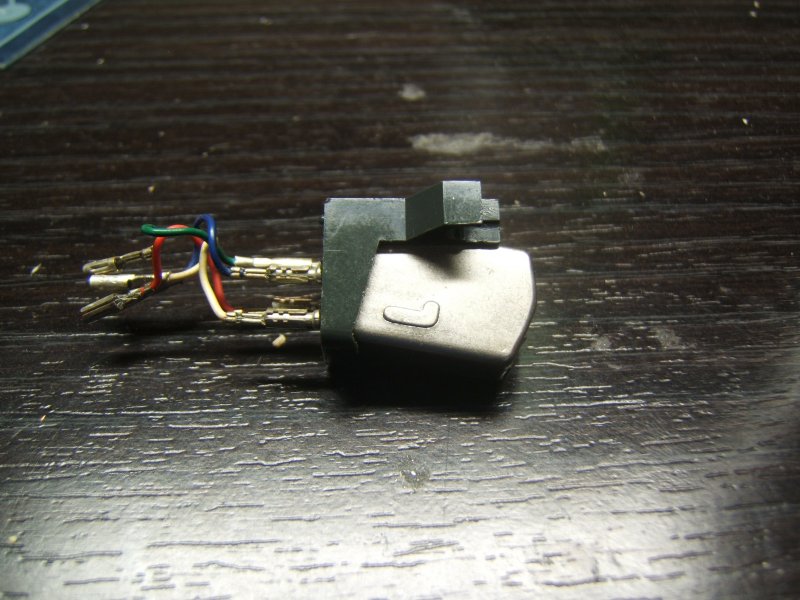

Folks, I'm still relatively new to vinyl, but found a Thorens TD125 MKII which I've been enjoying for a few months now. This TT had an 'ADC XLM' on it. (It's the original ADC XLM, not a MKII or newer). The TT with the ADC cart sounded fine to me, but I sent it in to be serviced, and the tech said the ADC cart wasn't sounding right. So he put on a used Shure M91ED. I have no idea what stylus. But it sounds pretty good. I didn't run it for long with the ADC XLM, but I think it sounded smoother, but maybe a little muddy. The stylus looked rough. After reading up more on the ADC XLM, including some excellent advice from my previous post here, I am still intrigued by this ADC XLM and feel like it should be back on this TT. Because it is impossible to find an original stylus, I ordered a JICO replacement, which just arrived. It's specifically for the XLM. Now I'm wondering what to do.
This TD 125 has a TP16 tone arm, I think MKII. I'm not going to attempt to change and set up a new cart. I'll send it in to a tech, which is kind of a pain. So it's kind of a big decision now. Should I keep the M91ED on there? Or should I reunite the ADC XLM with it's old friend. Is this even the right cart, compliance-wise for the TP16 MKII tone arm?

I have both cartridges. I like M91ED on my Empire 698 which sounds really good. I have also got a original ADC XLM, which has flat pins. The problem with ADC XLM is very difficult to find a stylus. I have tried Jico replacement stylus that didn't fit to the body, apparently only for XLM MKII. Last year, I found a seller at Amazon who sells stylus for XLM original. I used it on my Thorens TD 125MKII with SME 3009 improved. It has different sound characteristics. It is very sensitive to VTA and VTF, when set properly, it produces a more dynamic range, a bit brighter compared to DL-103R and Grado Reference Platinum that I used. It might not be as detailed as Denon, but it is more musical in my opinion, definitely a keeper. I think it will fit your TP16MKII just fine as it has low an effective mass, 8 g even lower that SME3009's 9 g. I have another TD 125MKII with TP16MKII, I will someday try ADC XLM on it just to compare.
TT newbie, that is very interesting. Actually (before my tech guy replaced my ADC XLM with my current M91ED), I emailed Jico for advice on what stylus to order, because I got a lot of confusing info online. I didn't hear back, so I took a chance and ordered one off the Jico site (part no.e000229). It fits on my original ADC XLM cart just fine. Obviously I haven't heard it perform yet. THEN I got a reply from Jico. Here's what they said:

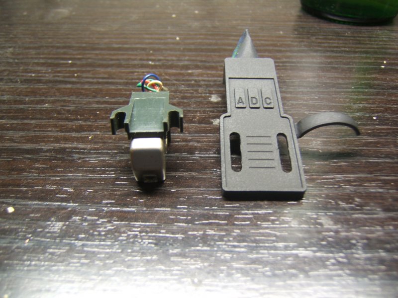

I am now unsure whether I actually have a TP16 MKII. It appears to match pictures of the MKII, but it's hard to tell. I just assumed it was because it was on my TD 125 "MKII", and somebody had (I suspect 40 years ago) installed this ADC XLM on it, which would have been a mis-match on the original TP16, which was 16+ grams.
The Jico stylus I got could not fit snugly on ADC body. Does your ADC XLM body have those weird looking flat pins? Yes, it was about $50 when I bought. I don't know whether they send me the wrong stylus. I actually gave the stylus to my friend who has a ADC XLM MKII which works perfectly.
I think it can easily tell a TP16MKII from TP16. MKII has a light weighted clamp style cartridge shell like this.
If you have TP16, it will be definitely not for ADC XLM as I only track it at 0.8g.

FYI, Seth recommended the e000229 for what he believes to be an ADC XLM, which according to a second source, might be a 1st gen XLM cart (but I found some contradicting info to this that states that the silver body indicates that the stylus that would have come with this cart is a QLM, although the cart itself would be identical to the XLM). The 'net can be full of info and its often hard to decipher all of it.
Mine has "normal" round pins. Perhaps the Jico e000229 only fits the XLM with round pins and the flat pinned XLM (like TT-Newbie has) is slightly different?
