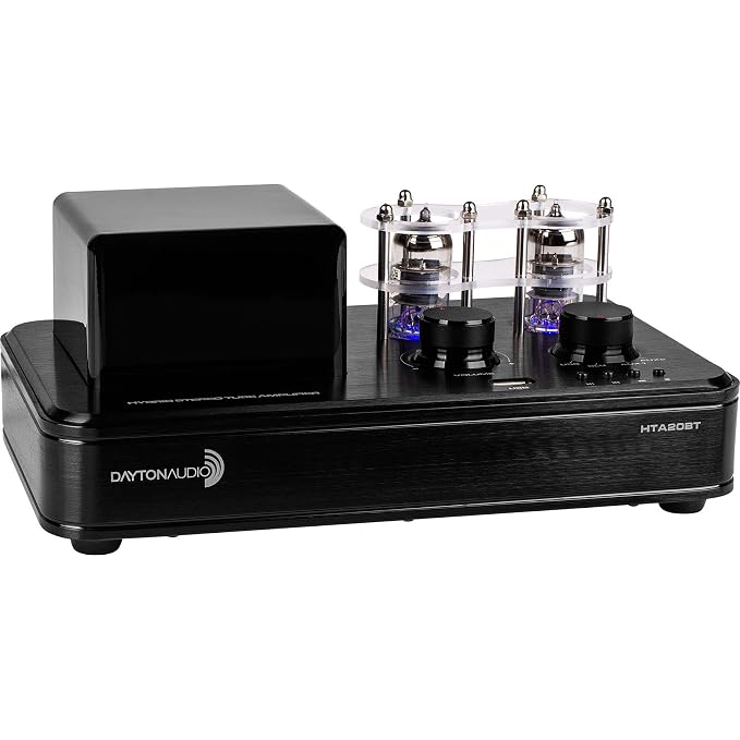

I wondered if I could get one of the small hybrid tube amps between the receiver and the Magnavox speakers -- that this might produce an input closer to what the speakers were designed for.
Something like a Dayton Audio HTA20BT:
If you decide to get a tube amp make sure it has 4 ohm speaker taps. You really don't want to run 4 ohm speakers on 8 or 16 ohm taps. You can run 8 ohm and up speakers on 4 ohm speaker taps on tube gear. Although it will reduce the power output. And if it's a hybrid with tube front end and SS output you still want 4 ohm speaker connections though. There are plenty of single ended and Push Pull tube amps out there at around 10wpc for not too much $$. Either way, a lot of these amps just have a volume control. So you could run from a preamp out on a receiver or integrated to the tube amp. Just leave the volume control at max on the tube amp using the volume control on the receiver to adjust volume. Or use a tape out from the reciever to the tube amp and use the tube amp volume control. No tone controls in circuit using the tape out though.
