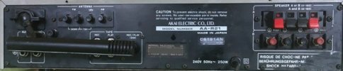

Well, shoot. Gave the AA-R21 service manual a look, and it looks like there are enough dissimilarity between that and my L model that the schematics won't translate 1:1. So, if anybody has the AA-R21L owner's and service manual lying around...
Looks like the two models are fairly similar, just not identical. They probably share parts with different layouts. Enough to confuse a first timer like me, though.
  • The R21L has front switches for LW and MW where the R21 just has AM (in addition to the FM/phono/AUX switches on both).
  • The difference in back panel layout should have been a dead giveaway. Here's a photo of the R21 backside, from Reclaimed Audio:
Compared to my photos of the L in the opening post, certainly the antenna and mount are different. That may or may not turn me around enough when I need to get into the innards?

i do not know if i removed them or left them in the unit for a spray & pray. considering that i do not have a more broken down pic, i do not think that i removed them.
