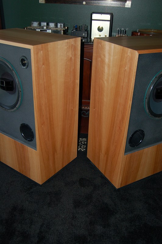

This is still a project in process but far enough along that today Watt and I did a little test and tune. We both really liked what we heard. Now to add the second cabinet brace, build the crossovers and veneer.
We used the original crossovers for the initial test. We ran the wires out of a port tube because the backs have not been cut yet for terminals.
Now we just need this guy to make some decisions about veneer. :D
Thanks again, Luther. These look and sound spectacular. And I think they're only going to get better.
Yes, the additional bracing and the better crossovers will only improve the sound. The furniture grade finish and the inset grill/cloth will greatly improve the esthetic.

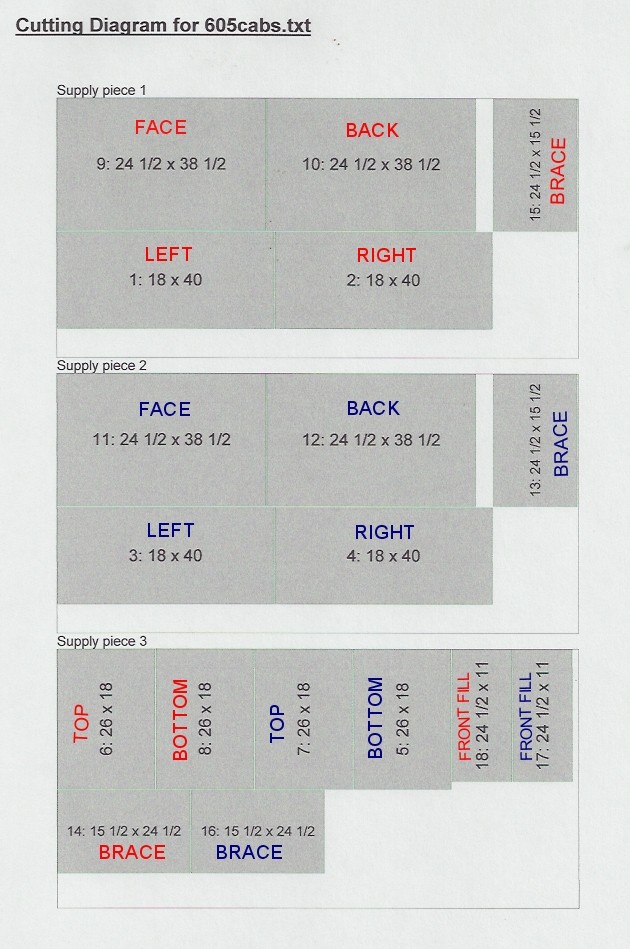

The basic design is a 620 cab. The cutlist above will allow you to 45 the corners. I trimmed after cutting to do butt joints. Also used different bracing, and porting. The front baffle is recessed and a bottom fill panel used to allow a recessed grill.

Well, if neither Watt nor Wardsweb object, I think I'd like to use this design to build out for my Altec 605B's.
I do have a couple of questions though:
1. Are the braces butt jointed as well or did you dado them?
2. What are the size of the ports?
3. How high up does this place the center of the drivers from the ground?

Watts cabinets are a little different as you can see. The front baffle is inset 3/4" to allow for the grill to sit almost flush with the sides. They use a totally different bracing system. They sit on a 2" skirt with removable spikes. The ports are now dual round and the crossover is inside with the attenuator in the upper right corner of the front baffle.
Watt can fill in the final version of crossover he used and how he lined the cabinets with Roxul.
