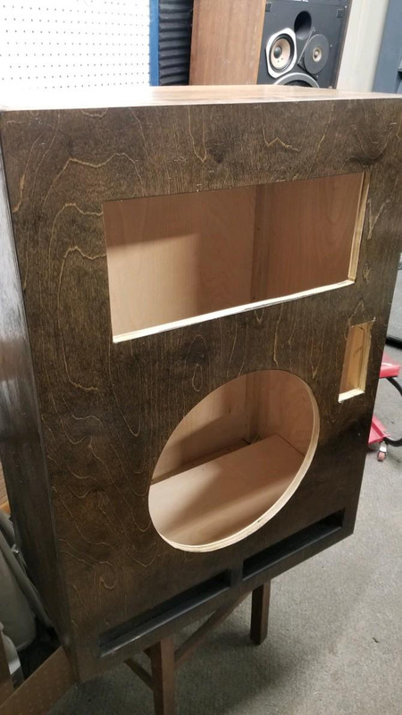

I am using Altec 423 for the 15's, but I could not find a pair of 804-5-6 drivers when I was looking, and there was a lot of questions on forums like this about what sounded better, so I asked a customer / and friend what he uses, and thus came the Eminence 2002's.

I agree, with no damping in or near the port opening. Line the walls and/or see what they did in the Model 19.
Do you know the internal volume off hand, I could look it up but I have a feeling that you already know.

Very NICE!
It's a smidge over 8 cubic feet.

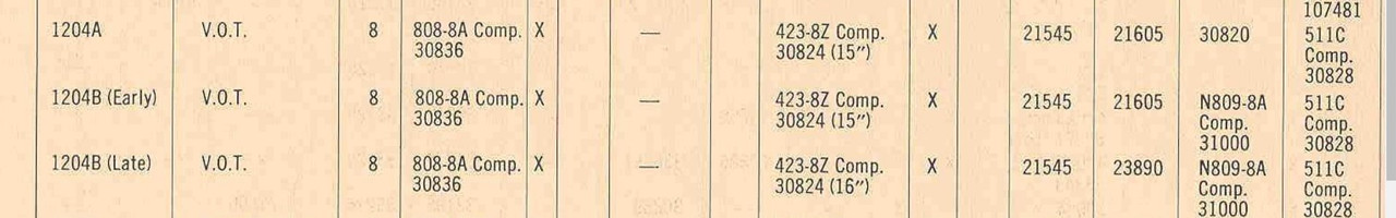

The thing is, I don’t think it matters what they did in the M19. The OP is not using the correct drivers for that. He has an MI woofer and Eminence HF driver.
I’m not saying that’s bad, just different than the Model 19. They look closer to an Altec 1202/1204 to me.

Romm is 12x12 treated with acoustic foam where possible. The "sound system" will be my console going to an Orban parametric E Q to shape when needed, then to a Hafler 120 watt amp.
Once I get them going, I have a friend in Nashville, with a Pioneer Hill Spectra Plus SC who is coming down to R T A the room.
Yes these parts are more 1204 than anything else. I didn't know at the time of purchase that any later edition 12" in a VOTT system was not equal to earlier iterations of same.
