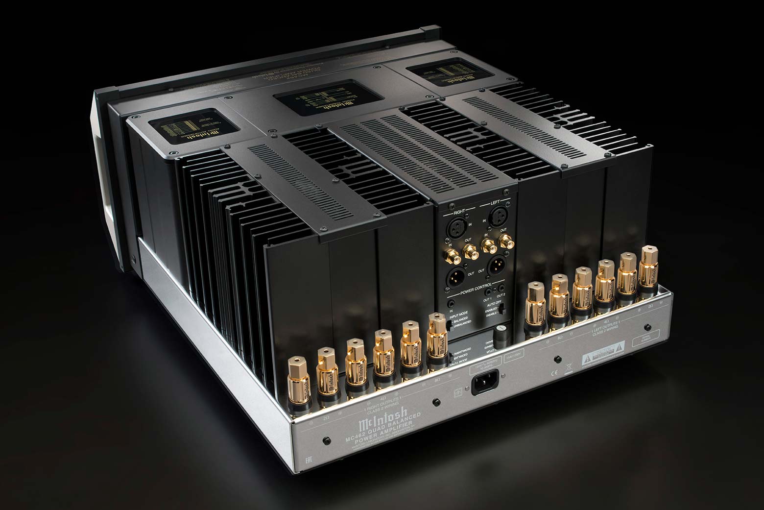

Can you name a single solid state amp with an "8 ohm output " tap?

Thanks, I had no idea. What is the age of the amp?
From 1967 - present.
Here's a current model, the MC462.
MC462-Back-Angle-background.ashx
