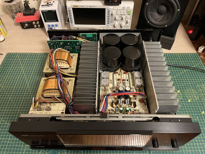

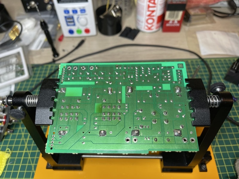

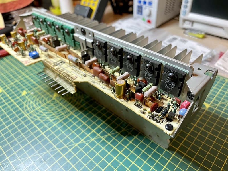

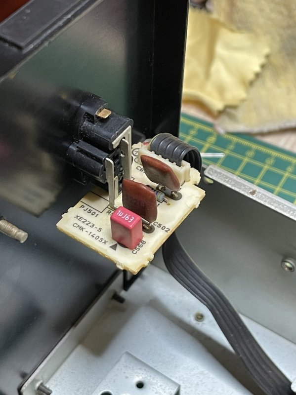

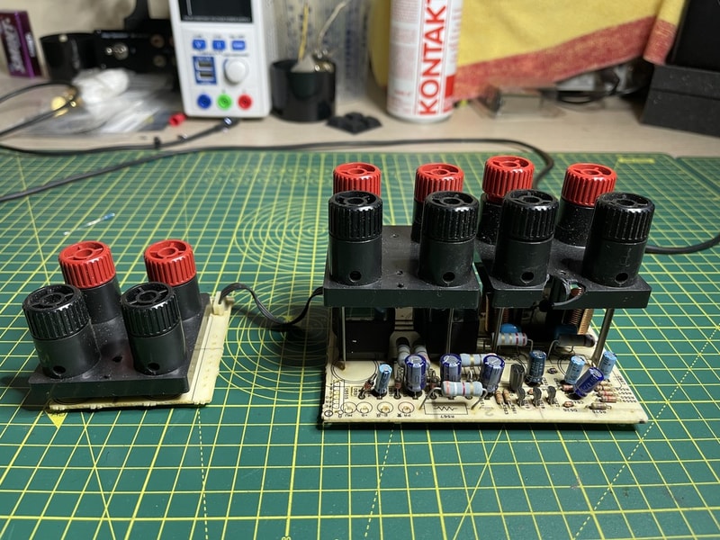

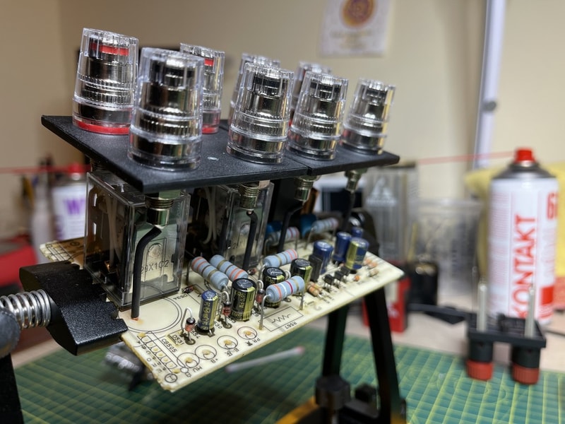

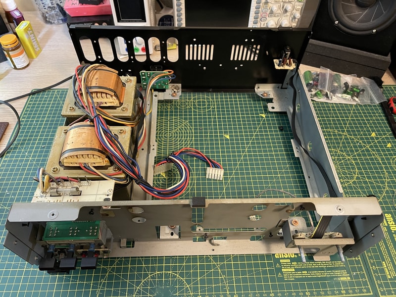

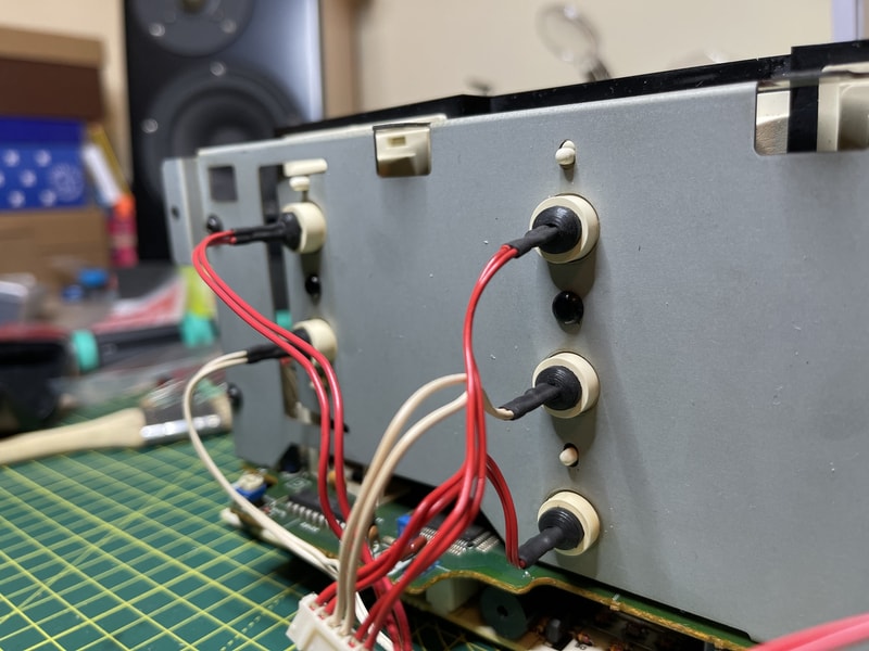

Here are some pics of the latest addition to my collection.

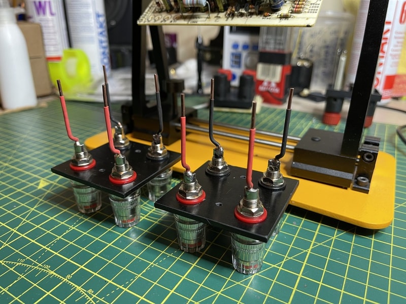

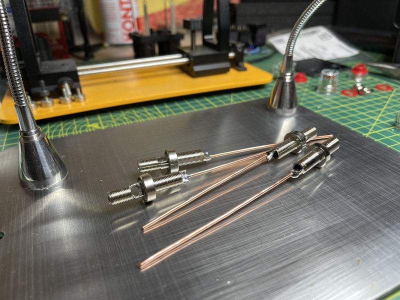

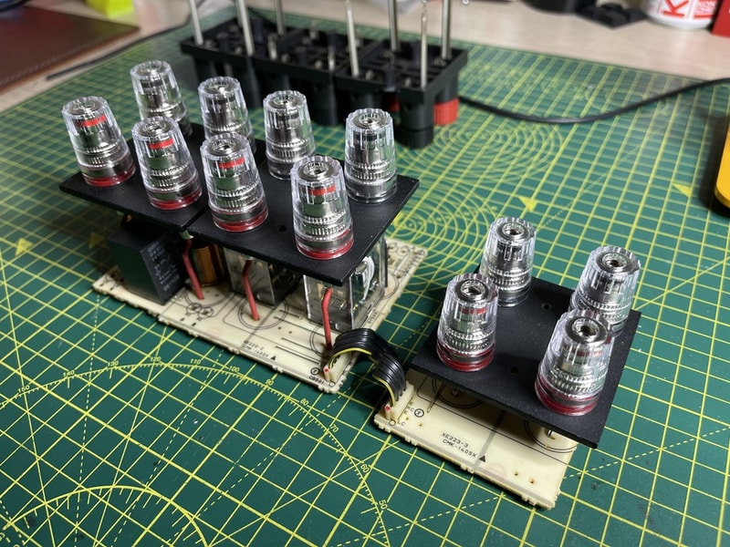

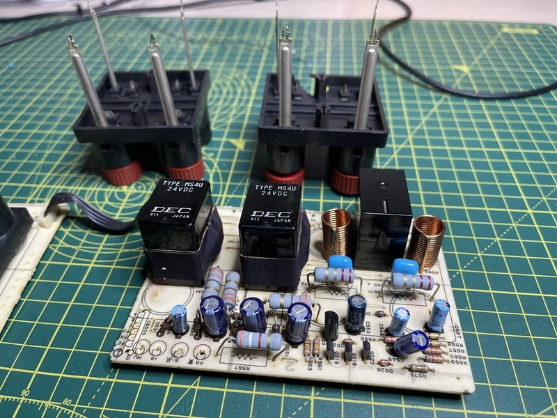

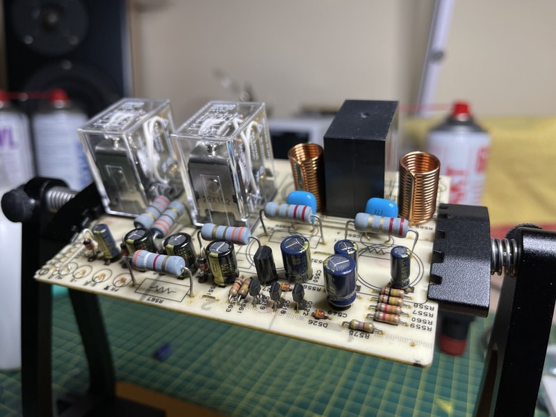

1- Speaker binding posts
New binding posts, capacitors and relays.

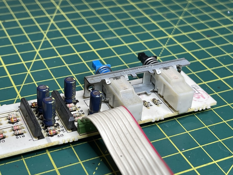

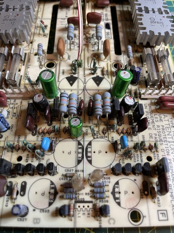

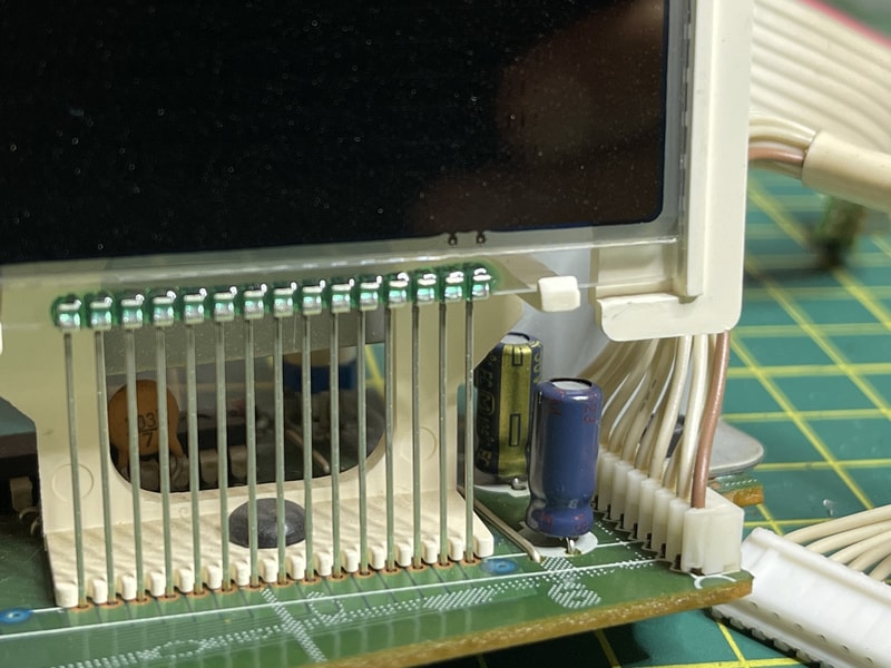

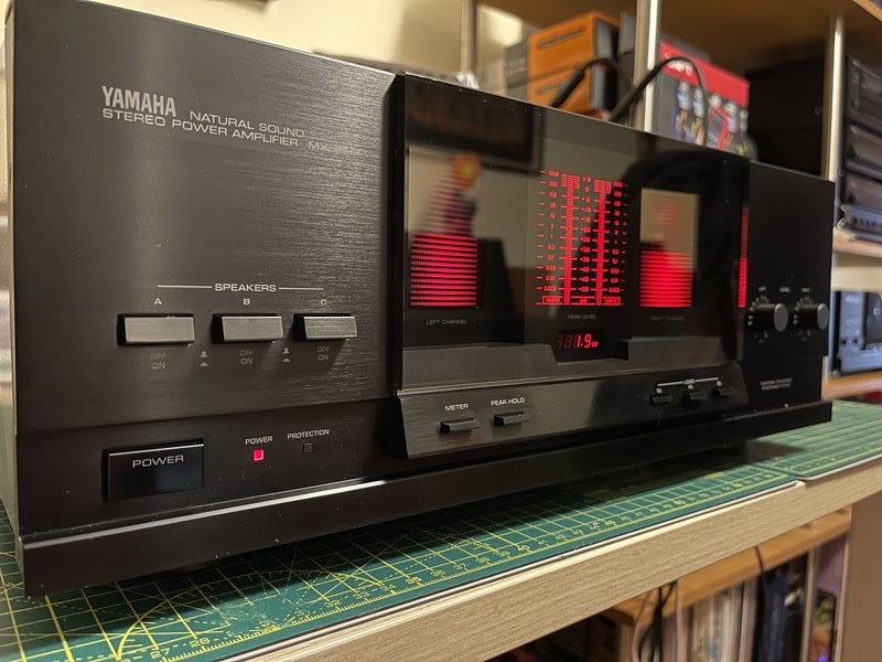

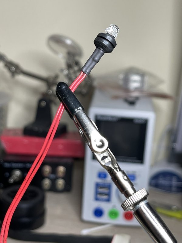

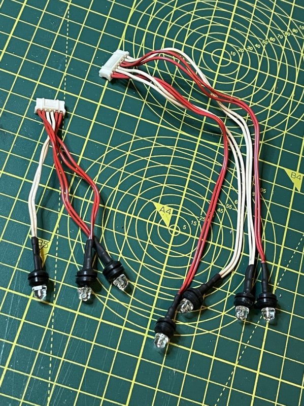

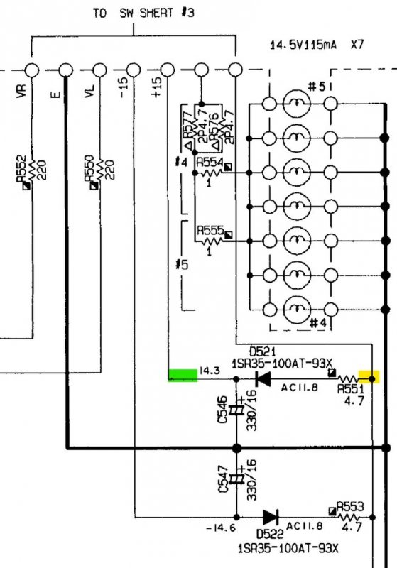

4- Conversion to led

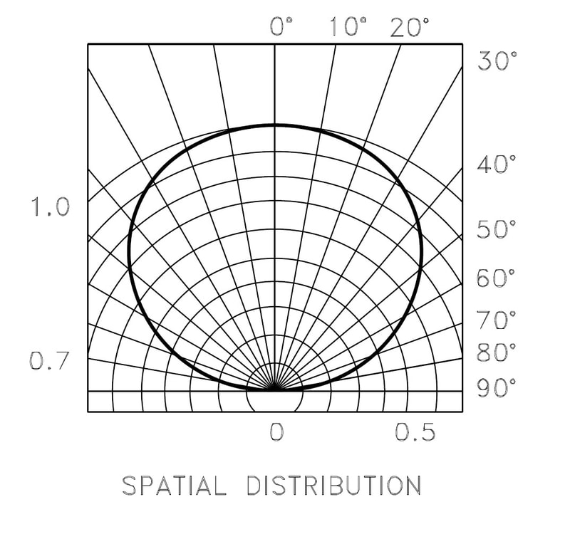

The goal was to achieve the same lighting (color, intensity, dispersion) as the original bulbs, but without the problems associated with the generated heat.

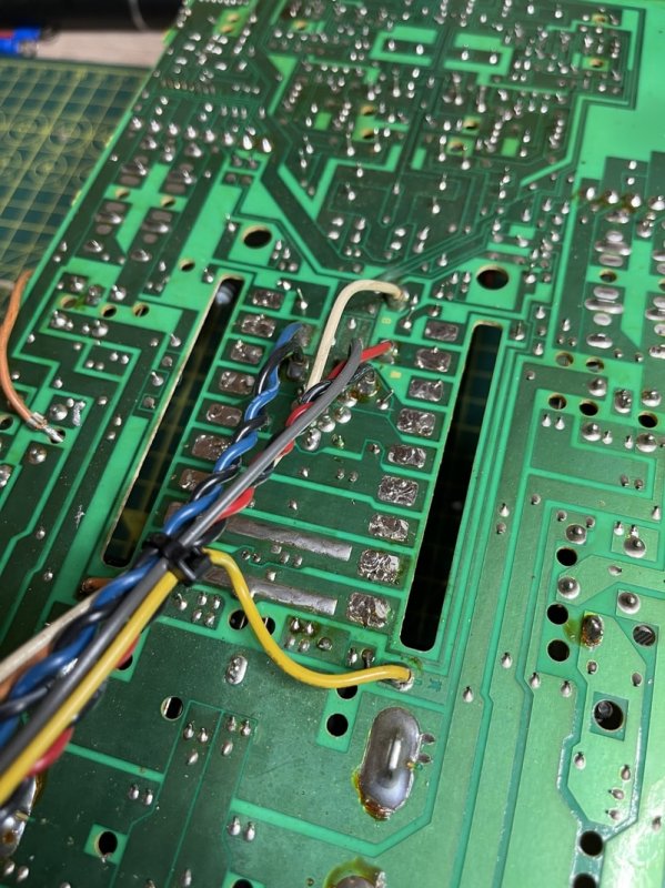

The power supply of the lamps were changed from AC (yellow mark) to DC (red mark), simply changing a jumper (reversible). This simplifies the change from lamps to LEDs, since only one limiting resistor is needed per diode. And it avoids the slight flickering that occurs with a half-wave rectifier. As each led only draws 2.5mA it does not represent any problem for D521.
Wide dispersion red LEDs have been used
The original wiring is reused

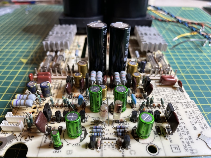

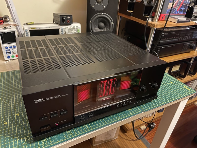

5- Final assembly
6- BOM

You and @rottalpha make me want to do another one, this time with LED's. Really nice work both of you! Love the work you did on the binding posts. I ordered mine from Germany and it took over a month to get them.

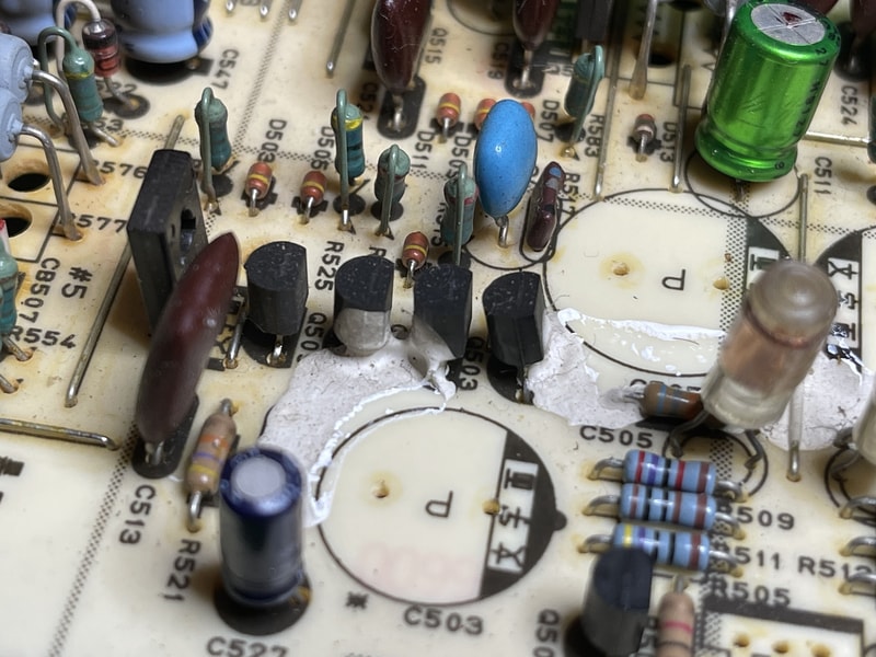

What did you use to get the white glue off ?

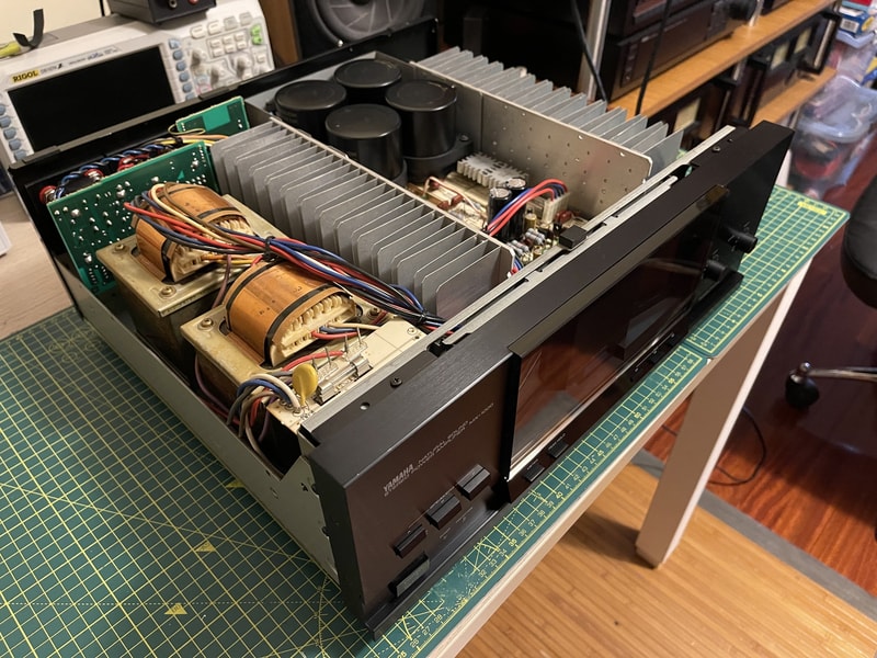

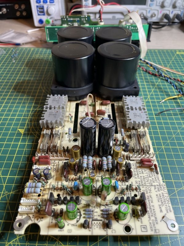

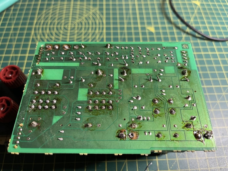

I assume that you use a DBT when first powering up. Is a 100W bulb adequate for an MX-1000?
Did you connect the main board and the two APS/Output boards with jumpers to leave room for troubleshooting, or do you first test the main board standalone?

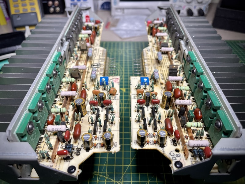

Yes, I used a DBT with a 100W bulb. It works fine.

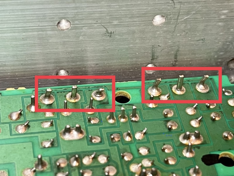

As the amp was working fine (despite cold solder joints!), I didn't expect any major problems. So I assembled the subboards directly, but using small amount of solder (so that in case of problems I could disassemble them without overheating the pads). Once I verified that everything was working correctly, I did the final solder.
