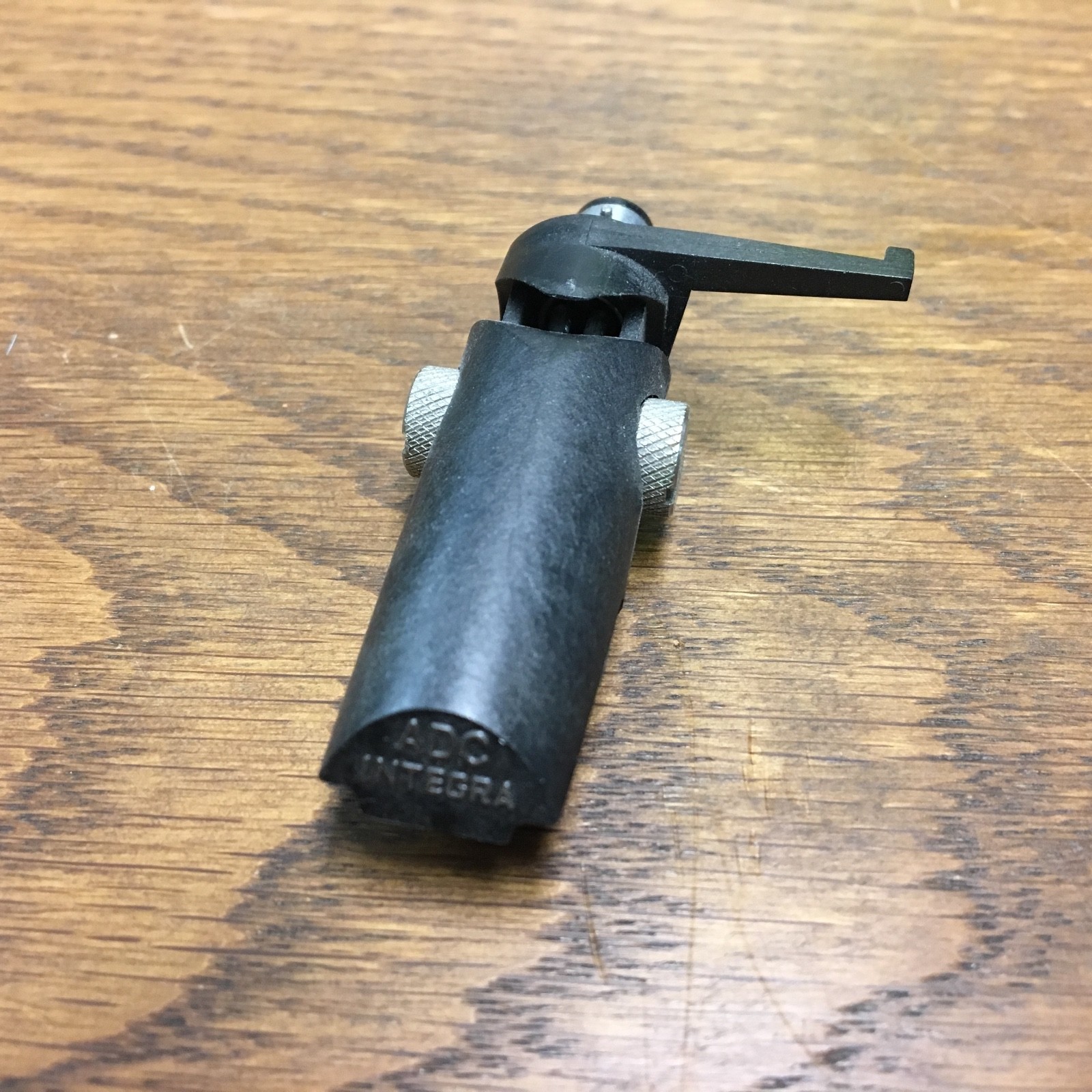

I added another ADC Cart to my collection
Which stylus would be the right one for this from VoM?
Measure it to be sure, but that's almost certainly the uniquely low-inductance (260mH) Integra model. It usually shows up with a CF-100 stylus, which won't be easy to find. Though it's basically an Integra version of the QLM 32 Mk III, the K series styli will also work. Any Integra stylus is more advanced than either of those; the 114-DET would be my currently-available top pick. If you don't want to throw that much money at it, go for the K8 conical. There are also a few good aftermarket styli-- make sure they're meant for Mk I or Mk II bodies. The CF-100 Integra variant can be spotted by the extra-thick single-piece thumbscrews with coin slots (but no threaded holes for auxiliary weights) on either side. Hint for owners of riginal-series XLMs or VLMs: the CF-100 is ideal for playing those old hypercompliant styli in your medium-mass curved tonearm. The reduced effective mass cuts down on the wallowing that happens when a high-compliance stylus tries and fails to control a heavy tonearm.
