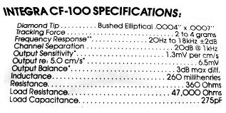

So, from a little research on this, it seems that my body is the same as the Integra CF100??
The resistance I measured was 360 Ohms on mine (ADC QLK mkIII).
Wualta, what are your thoughts on that?
Would it be possible to fit the needles from that on mine?

Yes, the CF-100 stylus, if you can find one (they're not common in the US), will work properly in your 30 body.
