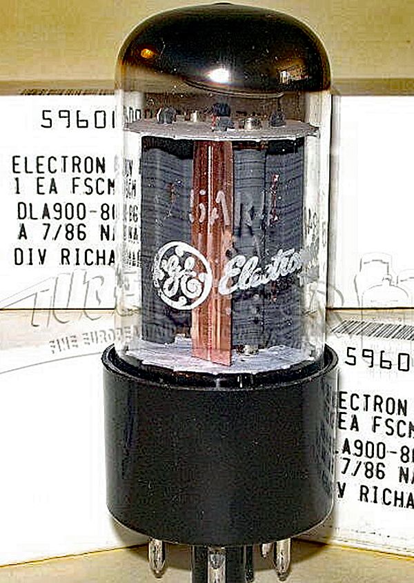

I have some US-made 5AR4, its in a fatter bottle than the Mullard ones. Can't recall offhand if its GE or Sylvania though. For some reason I'm thinking GE branding, Sylvania production? Or maybe I have that backwards.
I have a Mullard-made one with odd branding too, I want to say is "6202 Valve" or something like that. Apparently they were a British reseller like National Union or ElMenco. Got it NOS in the box. Dog ate the box unfortunately, but the tube is in my Fisher 600.
The Sylvania-made 5AR4s I've seen are the fattest; GEs are like Mullard. I've seen RCA 5AR4s made by Mullard mostly, but also GE and Sylvania.
If they have an exposed copper edge, they are the GREAT GE (Owensboro-made) 5AR4. :thumbsup:
