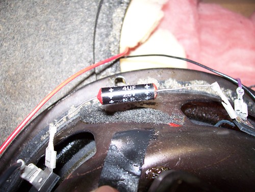

This is one of the caps (I think):
100_3081 by Wigwam Jones, on Flickr
I think it says: 4UF 25V N.P.

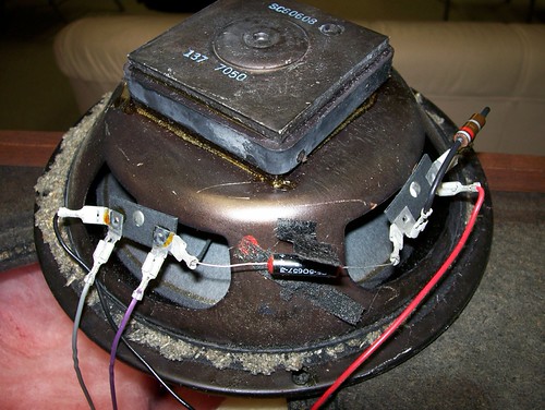

Then there is this thing. A resister? Can't tell, and I'm afraid the colors are not really very helpful to me. I hope my photo is displaying them in their true form:
100_3084 by Wigwam Jones, on Flickr
100_3085 by Wigwam Jones, on Flickr
So is this the entire 'crossover' network? Just a cap and a resister? Should there be some coils or something down inside the speaker guts? I haven't pulled out the fiberglas yet, but I can.

Looks like white, red, gold, silver. That'd calculate out to 9.2 Ohms +/-10%
Really hard to tell that first color but I don't see any silver listed for a primary number so it must be white.
Gray-red-gold, maybe? That would be 8.2 ohms. That's a pretty standard value.
Looks like a cap in series with a resistor, then to the tweeter.
With that, you can substitute another tweeter, pretty much without having to worry about the crossover "freaking out" or anything. You may wind up needing to change the value of the cap and/or the resistor to "maximize" the use of the new tweeter, but it'll definitely be OK just to try another one...

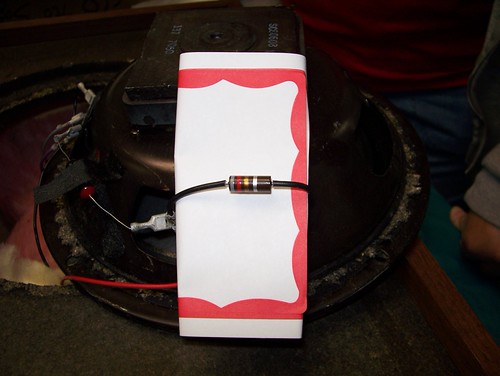

Wiggy, can you take a picture of the resistor, with a piece of white paper in-frame somewhere, so we can compare (and also, to "trick" the camera white balance into shading the gray part properly, if it is gray) that to the first band of the resistor?

Here's the photos you asked for:
100_3086 by Wigwam Jones, on Flickr
100_3087 by Wigwam Jones, on Flickr
Mrs. Wiggy looked at it and said grey-red-gold-silver reading left to right. Does that sound right?
OK, if I read that right the 4uf cap is crossing you at 5000 hz, which is high and good as you can use a lot of tweeters. The concern with tweeters is that they can go low enough to mesh well with the woofers, but 5000 Hz is pretty high so you can use almost anything.
Wait a sec... you gotta consider that resistor in series, as PART of the "load" that the crossover cap will see, when considering the effective crossover point!
Adding them, that's about 16 ohms (8.2 for the resistor, 8 plus or minus a bit for the tweeter in series). That would make the crossover more like 2500 Hz.
That's OK for the CTS cone tweeter in question... and would also be fine for something like the Dayton Classsic DC28F soft dome (they're OK down to 2KHz). It would also be just fine for the EPI dome (if you used the EPI or Dayton tweeter without the resistor, just use an 8uf cap instead of a 4uf)...

Replacement tweeter? The Dayton Classic DC28F from Parts Express. No question. It should work with simple (i.e, just a cap) crossovers OK. Might need some resistor for an L-pad, but I doubt even that. For less than $20 each, they're pretty darn good!
EDIT: The EPI/Genesis type inverted-dome that Andy suggested should also work well. They'll definitely play well down to below 2000 Hz. The factory 10uf cap is about 1800 Hz, IIRC...

Basically, lose the resistor and put in an 8 uf capacitor, if you are going to use Andy's EPI tweeter, or the Dayton from Parts Express.
