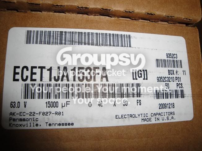

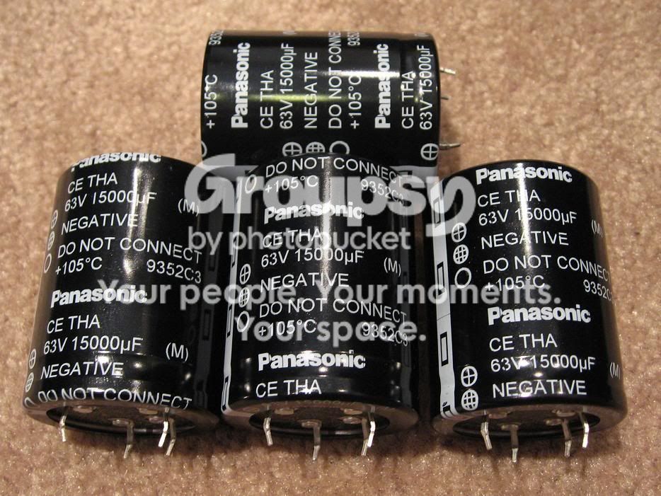

Another piece in the puzzle... some Panasonic THA 15000uf 63v caps. These are a slight upgrade in capacitance over the standard items (15000uf vs 12000uf). Same capacitance as the AU-717.
These can be had very cheaply from Apex Jr ($2.99ea) and based upon the evidence presented to me, they are legit.
The only downside is their size - they are 40mm diameter as per the standard caps, but only 50mm tall. This is a cosmetic issue only. The standard caps are 100mm tall from memory.
The 15000uf 80v Panasonic caps that Echowars used in his recently restored AU-517 are taller (80mm) and look nicer, but I just couldn't pass up the pricing on these caps from Apex Jr.
I don't think that I will fit them straight away. Hopefully skippy124 and I will do some testing after the remainder of the restoration is complete, to see how the amp performs with the old filter caps still in place. We'll then fit these at some time in future (or immediately if any issues are revealed with the standard caps) and undertake the same testing to see the difference (if any).
We'll need to solder on some lugs or ring terminals to facilitate their installation, but it shouldn't be too bad. The two support pins will be clipped off to avoid any confusion or fouling on any wiring etc.
Those particular caps are at least 2 generations obsolete (i.e at least 2 series of these caps have come and gone since.) So they are at least a few years old. Maybe even 10 years old... I don't exactly know...
Either way, I would expect them to perform much better than your dried out originals. Have you ever cut one of these big filter caps apart and looked at the innards? Some of them are pretty dry. Others loose their electrolyte which corrodes the terminals off (due to the upside down mounting) from the inside-out. Either way, I wouldn't reuse the originals unless original cosmetics are more important.

Thanks Scott.
The original packing box was dated 18 December 2009, so I am assuming it is either the manufacture date by Panasonic, or the packaging date:
I'm surprised that Panasonic has had two new versions of these caps since that time! I guess they move quickly.
As you say, these would be in far better condition than the originals. EchoWars has also told me to ditch the originals if I'm serious about wanting this amp to last for many years to come, and that makes sense to me.
I need to 'walk back' my prior comments on age. I hadn't run across this cap in the past because nobody seems to stock it. Further researched convinced me i didn't know wtf I was talking about. It's a great cap, and you got a great price on them.
Hey, at least the diameter means you can use the stock clamps without extra fuss. Half the AU-717 that I've crossed paths with this past year have at least one corroded, leaking main cap. I think you are smart to use them, especially if you like to turn it up now and then.
Scott
Phew... I feel a little bit better now. Heart attack avoided!
I probably should add a huge thanks to EchoWars for his advice in previous PMs.
Glenn suggested that I be EXTREMELY cautious regarding caps bought from sources that don't buy directly from the factory or distributor. As a result, I did a fair bit of research on the caps and interrogated Steve @ Apex Jr for some time regarding the source and history of the caps. Steve had an issue in the past with a batch of fake Hitachi caps, and as a result I think he is quite particular about who he buys surplus stock from. Personally, based upon the evidence presented to me, I am 100% satisfied that they are legit.
One of the caps was actually dented in transit, so Steve replaced it for me. I might cut open the dented cap and have a peek inside and take some cross-sectional photos.
I just HAD to try them at this price. It was worth the risk. Nichicon Gold Tunes, whilst a great cap, would have cost me $130 landed in Australia. Buying these Panasonics from the usual outlets (whether in the USA or Australia) would have been $70 landed in Australia. These cost me $36 landed from Apex Jr along with about 30 other caps (mainly metallised film, poly caps and orange drops for experimenting, crossover and bypass purposes).
