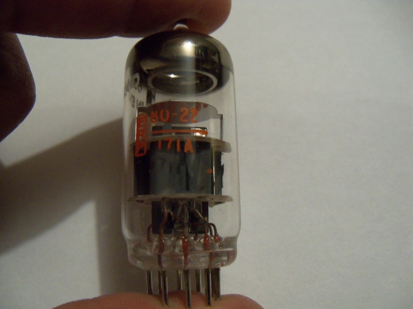

https://4.bp.blogspot.com/-Gvgsq_a0ry4/VjrLrz2ZvDI/AAAAAAAAAuM/w25HrPozpgU/s1600/100_8034.JPG
https://2.bp.blogspot.com/-mjFJDRM2-cU/VjrLtjl2wVI/AAAAAAAAAuY/wePxssxnnmE/s1600/100_8036.JPG
These were labeled Dumont, sold as manufactured in England but ultimately turned out to be relabeled Tungsrams. Purchased 6 pcs from eduarsan1 from BarterTown several years ago.
Here is the discussion about these tubes.
https://audiokarma.org/forums/index.php?threads/nos-dumont-6922-ecc88-6dj8-tubes.687258/
BillWojo
This is a tube made in West Germany Branded for RCA.
From your pictures, it looks like a Tungsram. On your 2nd photo, the tag seems to be on the right next to the grey plates, if you see that tag, it would confirm the authenticity. The tags on mine are next to the grey plates. Mine are made in Hungary with non corrosive alloy pins (not gold). ,
Yep, mine have the tags as well and the pins are nice and shiny, like they were just made. I'll try a pair in the back two positions, V1 and V2 as dogscanskate mentioned.
Thanks for the info.
