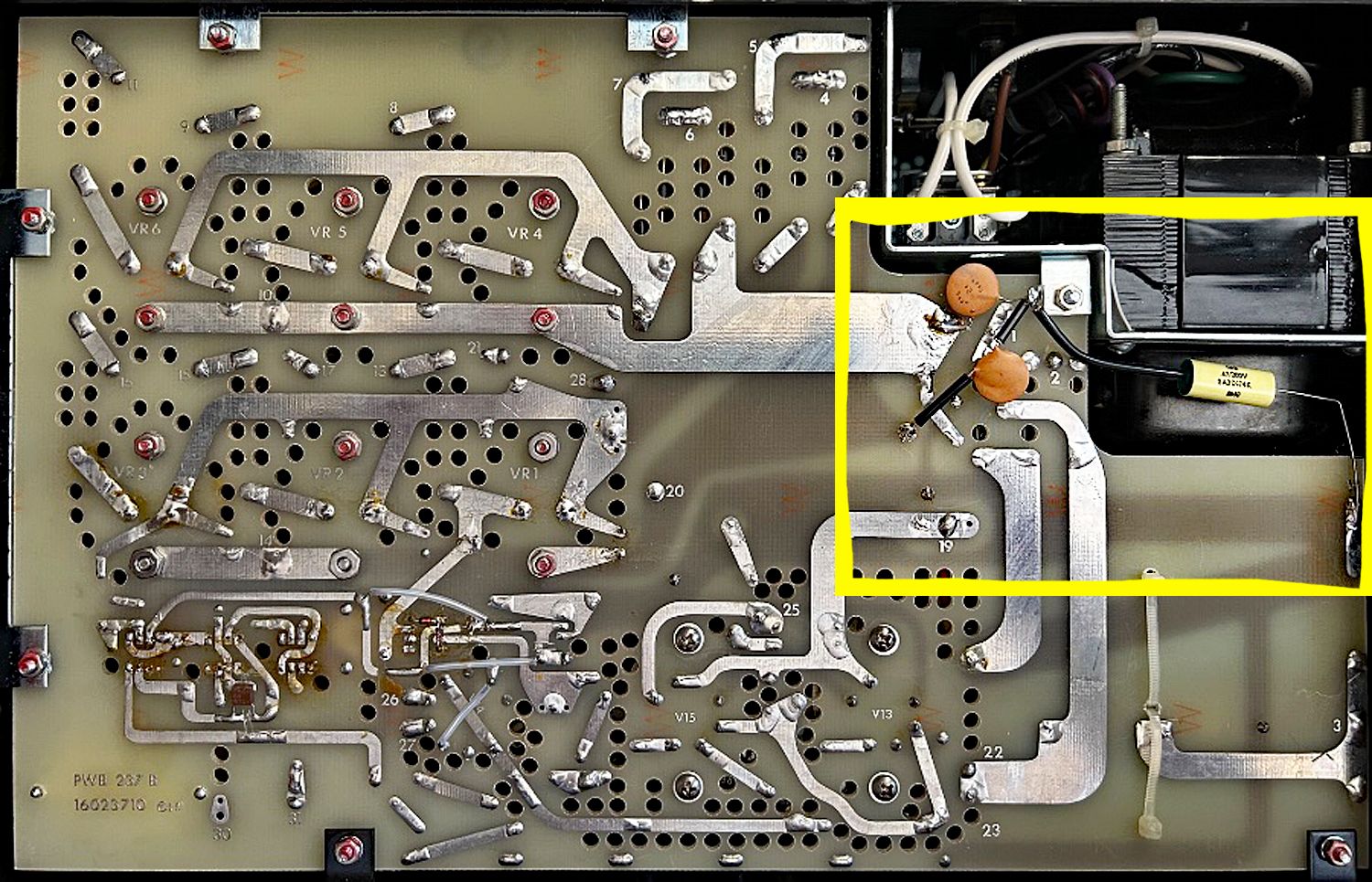

Hello all. I’ve inherited a broken SP10. First thing I need is a very clear picture of the underside of power supply PC board. Especially the area where the chips are. Pretty bad repair was made there, chips replaced, but some of the traces are gone. I will need to restore those. Would really appreciate if someone could send me a good picture. Thx in advance.

I think this board is restorable. I certainly would hate to replace/re-populate the whole PS board. I’d rather do some point-to-point wiring around those chips. I can trace according to schematic, but a good photo would save me a ton of time.

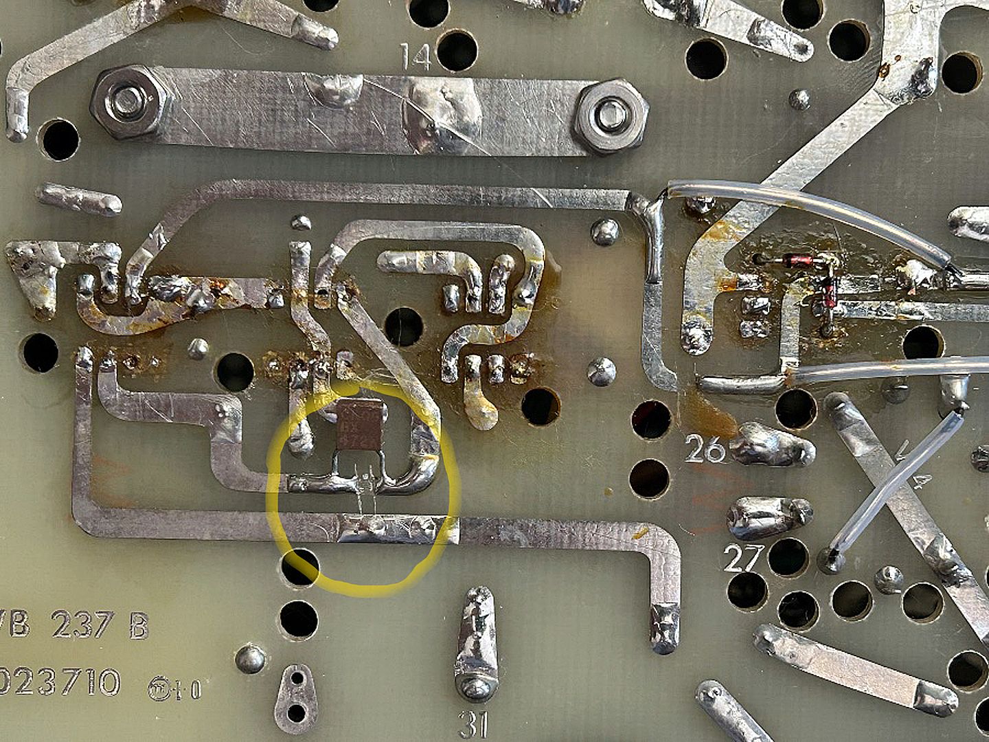

Here it is:

This doesn't look correct. :idea:

Actually I looked at the schematic, and this is - surprisingly - correct. I think this was a mood to later units. Everything here looks correct and actually connected, except the TL071, where the slides in schematic go from pin 2 to pins 4 and 7, and here they go from pin 1 to 4 and 8. I have to look into that.

The catwhiskers of the solder seem to be shorting across that cap. :idea:

I think I found at least one problem: L071’s supporting circuit’s diodes are not soldered to correct pins. Main complaint was that the muting circuit won’t open after previous repair, which involved replacement of a blown VR1 regulator and its L071 feeder. Well, muting circuit in this preamp is not only a time-delay. It also protects outputs if something is wrong. The diodes supposed to go from pin 2 to pin 4 and pin 7. Instead they are soldered to pin 1 and one to pin 8, both are not used on L071.

So it looks like this crazy connection destroyed TL071, and possibly more. So I have to go through this carefully, but I think this is the culprit. I still do wish I had a very clear picture of this PCB…
