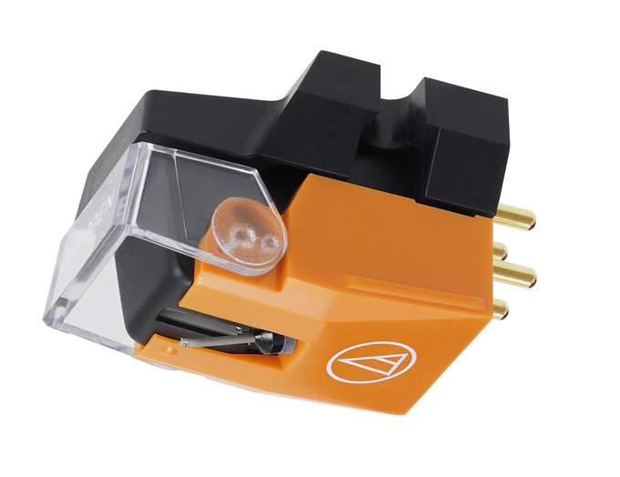

I've used this one (120E version) of the current VM530EN. Nude elliptical.
Not quite as detailed as the 440Ml, but a great performer both on my Dual 1219 and SL1200 MK2. Never sibialnce - Seldom IGD.
I've only gone away from it since I've been obsessed with Shure & Stanton stuff lately.
It appears AT specifications removes 0.5mv from the VM530EN output, as the 120E specs out a 5.0.
I think you would like it much better than the entry level 95.

But this is an elliptical, yes? I was looking to replace my 95 with a micro line...
Thanks for the info!
NOT ALL ellipticals are the same. There's a reason they are priced differently. This one is their top elliptical. The VM lineup is real Japan made too - Not China, if that is important to you.
Microlines are nice. But if you were wanting to save a little cash...
