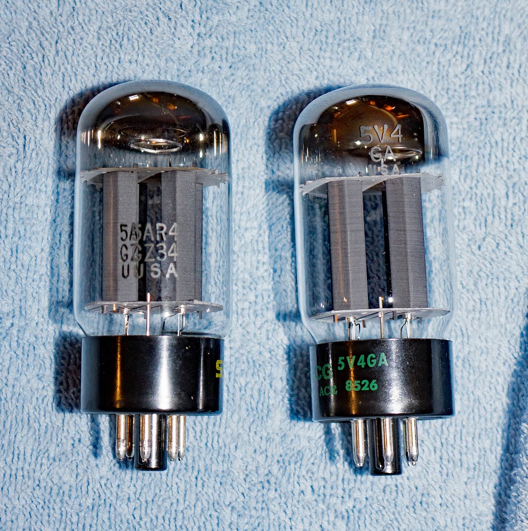

NOS GZ34/5AR4 are worth their weight in gold. As long as you have units that use them, NEVER sell them. :thumbsup:

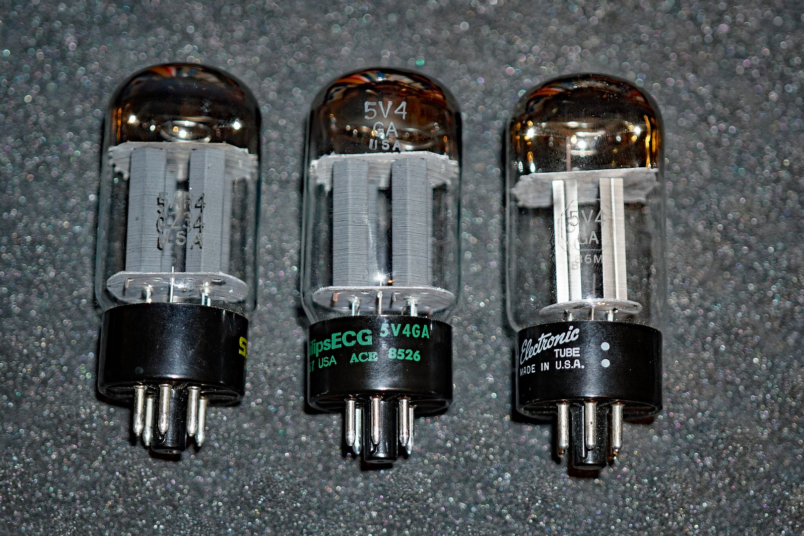

By the way, Philips-ECG (USA) made several batches of 5AR4, "5V4GA" labeled rectifiers for the military. Philips-ECG made the tubes using Sylvania 5AR4 jigs.
Sylvania 5AR4. Philips-ECG "5V4GA." GE 5V4GA.

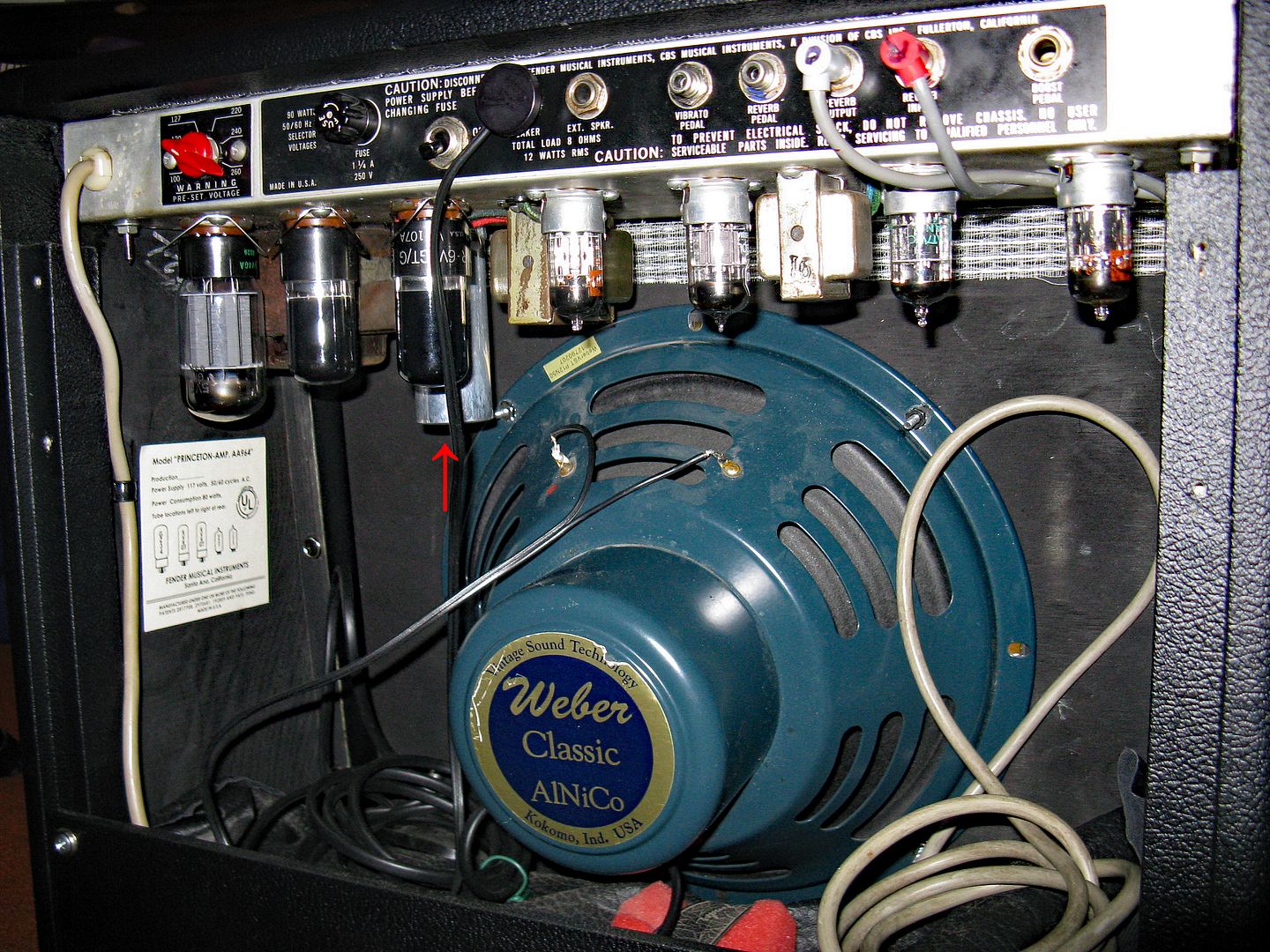

I've used these Philips-ECG rectifiers in several of my amps and in fixes for others. They test like strong 5AR4. The red arrow points to the 525-volt-rated cap can that I used to replace the OEM 475-volt-rated one.
There was this seller who would occasionally put these tubes up on eBay. He bought a pallet of them from a military surplus site. They were quite the deal for those in the know. I haven't seen his eBay postings in several years, but I keep looking. :)
