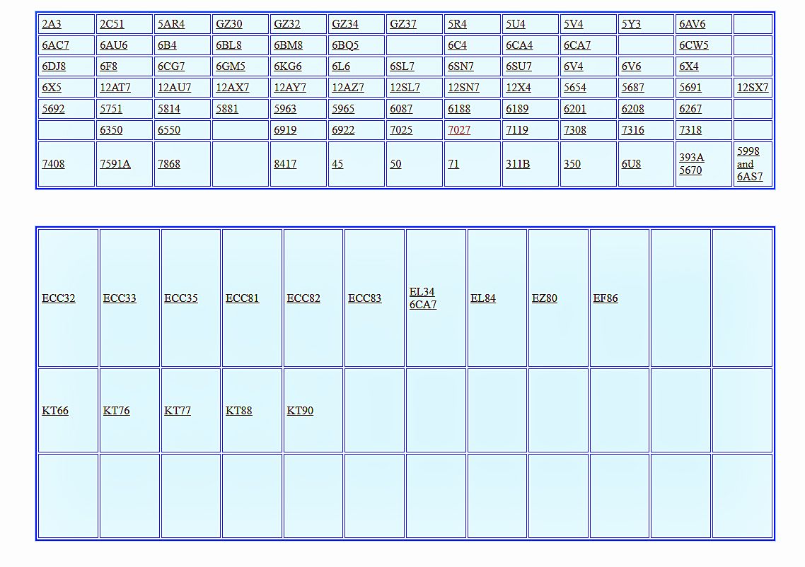

https://mkratz.pt/
Caution: extra slow site. Let each page load before doing multiple clicks. :)
My favorite reference is Ludwell Sibley's Tube Lore II.
Impessing compilation. In my "tube-list" now.
