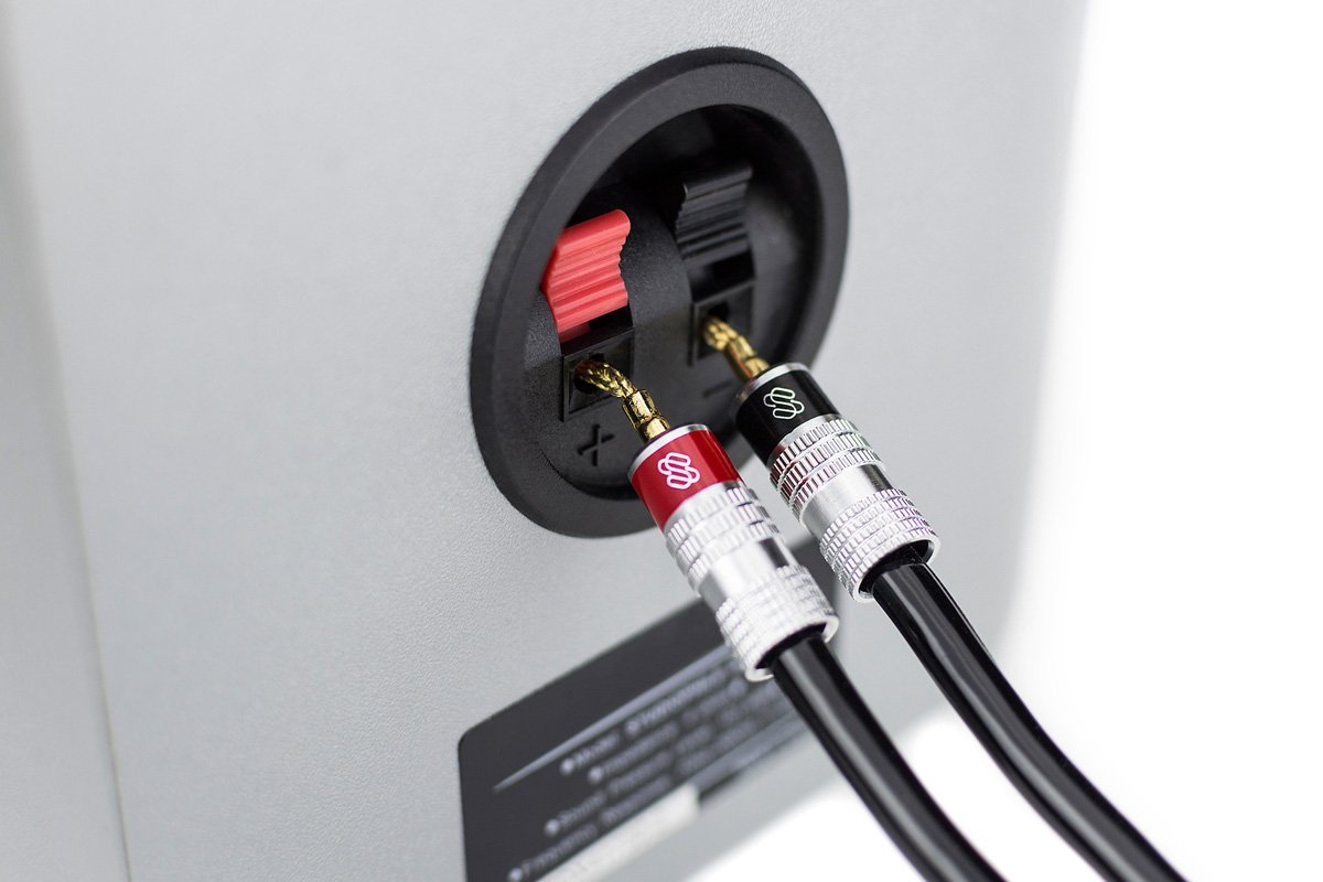

These may work. They accept banana plugs (which is how I use them) or bare wire obviously. I modified mine with a little shrink tubing for insurance.
The only issue is the flex pin itself is a little big but it can be modified to fit most spring terminals with a pinch with needle nose pliers.

I've done the exact same thing on my NS-10's and TF-500's, both use those awful small spring clips and I was able to fit the flex pins in place with only a pinch from the needle nose pliers.
