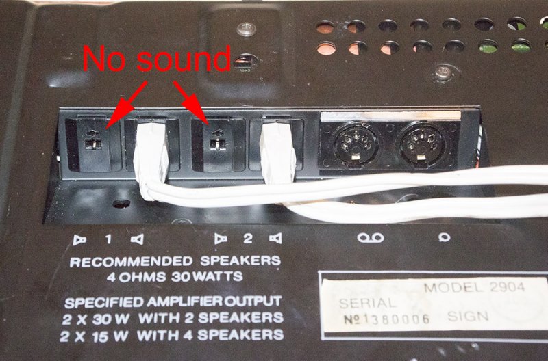

I have older Bang and Olufsen Beomaster amplifier 2400 / 1900 that is in almost perfect condition. However, when I Plug in either of the left speaker channels there is not sound. If I plug in the right on Speaker set #1 and #2 I can get Mono. (see photo). When I adjust the balance I can only get the right side.
So, there is not way to get stereo.
Is there anyway to repair the left speaker? I have a manual and could fix it if I knew want to fix.

Can you test if you have sound at the Tape out connector, in both channels?
You need to narrow the problem to the input connectors, speaker selector, preamp section or power amplifier section. You need to find where the signal disappear.

Good question. I will need to check the tape connector. However, as I remember the same issue occurred with the turntable connection.

Reading the schematic (page 16 on the pdf file) , 1st tests I'd do are:
check with headphones, and move the "HT2" switch, several times to ON -Off, to check if the headphones or speakers have sound.

Check at the Tape OUTPUT (half of the tape connector is the output for a recorder) if you have sound
If you have sound at the tape out, and no sound with headphones, the problem is in the preamp or power amp, further testing is needed, I'd check at the volume control.
Balance control is were I`d look first on these. Check you have signal / out. A couple of machines I have of this period suffer bad balance sliders.
