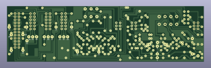

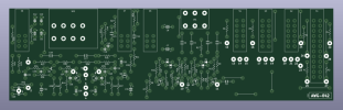

Here's what I've been up to. I've recreated the Flat Amp Board PCB (AWG-042) using KiCad software. I've replicated the original design with the same track shapes and symbols, but I've added component numbers. I'm planning to get some of these made through an online prototyping service. Hopefully they work the first time! This is my first attempt at creating a PCB, so any feedback is appreciated.
As a backup plan, I also got my hands on a replacement AWG-042 assembly from eBay, just in case I decide not to go ahead with the new PCB.
Here's the new PCB. Before I send it out and attempt to use it with my SX-1250, I'll need to thoroughly triple-check everything.

Today, I received the new AWG-042 Flat Amp board PCB, which I had manufactured through PCBWay. In my opinion, it looks good. The minimum order quantity was 5 boards, so I'll have 4 extras available for anyone who might need one. I'll list them on eBay. I've thoroughly inspected this new board and everything appears to be good.
Initially, I was a bit undecided about using it to repair this receiver because I was able to obtain the original replacement board. However, the replacement also has some minor damaged traces. Consequently, I've decided to proceed with using the new one.
Old vs New Flat Amp Board AWG-042 - Side 1
Old vs New Flat Amp Board AWG-042 - Side 2
