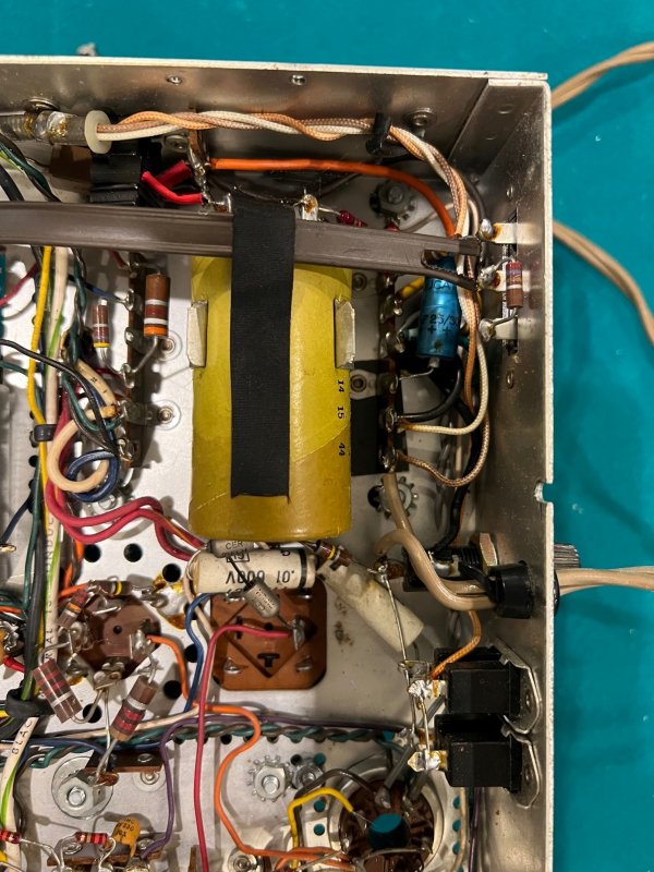

So now I have enough tools to be dangerous. Plugged my 400 into the DBT without the power tubes in place and the 150 watt bult glowed brightly and then dimmed down to a faint glow. At least that part looks right. Now I need to dig further.
Any recommendations on what to test next? I have ordered a new safety cap for the unit and will replace that when it comes in. I was thinking about putting the power tubes in and hooking up the dummy loads and signal generator and seeing where I am at but wasn't sure if that would be a prudent next step.

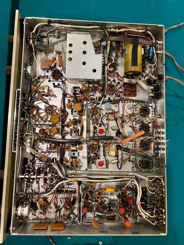

Some more pictures of the unit.
Other than that nasty power switch the 400 looks nice and clean. I restored one some time ago and it is a nice sounding receiver. Lots of good threads on restoring the unit here, there are certain recommended items and a lot of potential enhancements. Filter re-cap and bias supply rebuild are high on the list, then coupling capacitor replacements and screen stability resistors and and...:):):)

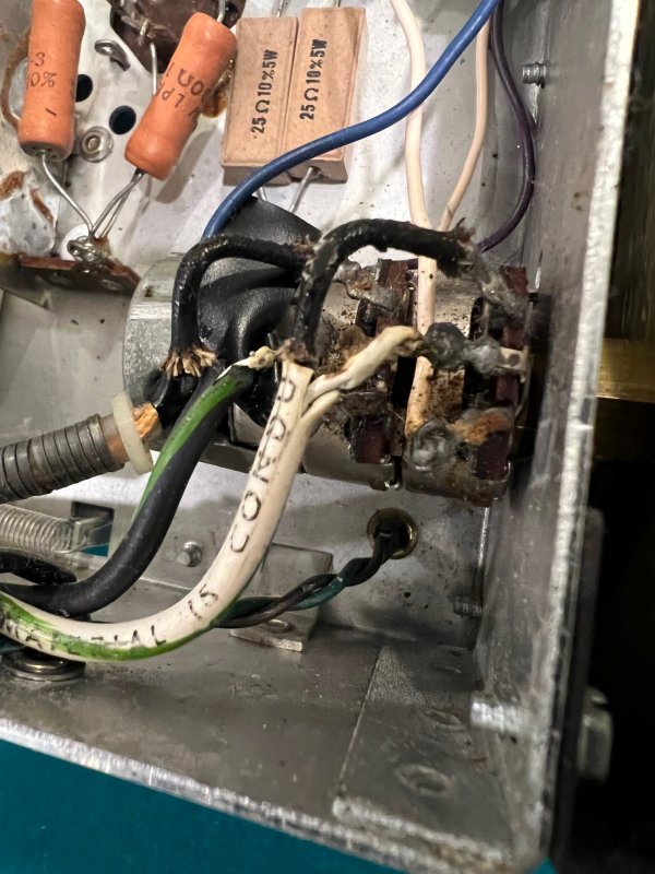

Very possible that someone sprayed flammable contact cleaner into that switch which is a no no. The power switches are know to go bad, we install inrush limiters to help extend their life.
.... Plugged my 400 into the DBT without the power tubes in place and the 150 watt bult glowed brightly and then dimmed down to a faint glow. At least that part looks right. Now I need to dig further.

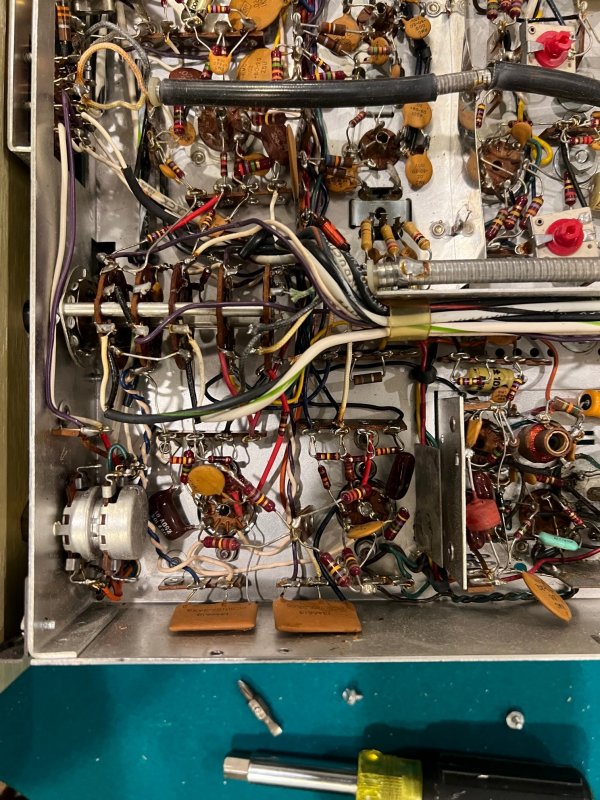

Curious: When you tested on the DBT, did you apply power to the unit via the 400's switch or via an external switch? That would immediately tell you if the switch on the 400 is good. Also, via the pics you've posted, there's no way to tell if there is arching damage to the switch. Oftentimes, the entire assembly is referred to as the "switch." Actually, the switch is the section at the very back of the component, the sections closest to the face plate being the stereo pot. Your pics show a really, really dirty pot which would affect proper tracking at best, or volume drop outs at worst. And the only way to determine the health of the pot is to use it.
I think it's obvious that someone has already messed with the pot for whatever reason. I'd leave it as an item high on the punch list once the other aspects of the restoration have been completed. Tearing it down for a thorough inspection and cleaning is work but fun for a committed tinkerer.
I tested it using the 400's switch. Really makes me nervous as there is significant signs of arcing and the wires are in bad shape. There has been some electrical tape wrapped around the wires to cover open areas. Whatever happened was energetic so I definitely have this high on my resolution list. A quick look at ebay returns no direct equivalents. There is a R50160-92 from a fisher KX-200. It is dual, 500k but a different model number. The 400 uses a R50160-104. Any idea if the latter would work?
OK, now we know that the SWITCH part of the assembly works you have to determine the health of the POT. Unless someone took a flamethrower to it, or fell asleep while soldering, there would be no reason to have any arching in the POT. And frankly, there is no way for an arching event to take place in the POT sections. Even if there was a fire in the switch, it is highly unlikely that it would migrate to the pots. I think what you have is burnt flux from a prior effort to either repair or replace the assembly. I'd hold off changing it until you can determine whether the pot itself is not functioning to your satisfaction. Whether you keep the existing pot, or replace it, you're gonna have to deal with the state of the wiring as you now have it. That's why I suggest holding off until you can thoroughly assess the condition of the entire shebang. No sense chasing something that you might not need. Also, finding a replacement pot is a real adventure, both in the quality of the replacement, and its cost. I'd hold off.
If you're intent on picking up a replacement Fisher pot, then I'm pretty sure the KX version will work so long as it is a 500k pot. I don't know if a KX has a loudness function but if it does, then I think you're set with it.
One last thing: I'd avoid using the 400's switch for now. Once you have a thermistor added, the ramp up is slow so you'll have to worry les about arching damage. Use the switch on the DBT, or other means to apply power. In all my units, even with thermistors and new switches, I power on with the switch on my bucking transformer. More paranoia than necessity but hey..... :
