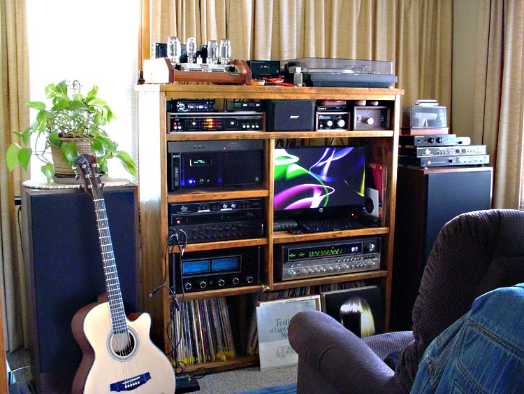

Hi all, My system hits low notes without any strain and sounds quite good. Luxman R-113 pre amp with a NEC A-910 amp pushing a set of DCM TF-600s. The CD Burn to Shine by Ben Harper really taxes my speakers to the point of rattle/Fart when I turn it up slightly and play the first two songs on the Album. Alone and The Woman in You. Anyone else have certain tracks that their system doesn't quite handle or familiar with these songs played on your own system? I just can't duplicate this flaw with any other tracks that I have listened to.Thanks for listening!

I just tried that song with no issues , no bottoming out whatsoever.

Agree. Its not the amplifier losing control. Its the drivers bottoming out.

The TF 600s are power hungry with a wacky impedence curve and useless below 40 hz in practice. Mine were badly behaved with a 100wpc amp, so I upgraded to a 300wpc amp which improved things. I also have the TF's rolling off at 50hz with an electric crossover. This made the biggest improvement, so the subwoofers take over the heavy lifting at 50hz on down.
The TF's are for delicate detailed listening. The tweeters are easy to cook and its not possible to move the ocean with a couple of 6 inch drivers per side.

I used to run them with a Sub with 50 hz crossover also. A solid 100 wpc was plenty enough to make them sound loud and wonderful. I have no issues with them at all with the sub. I moved into a smaller room and feel like they didn't need a sub at all until Ben Harper came along. I keep extra tweeters on hand. The Subsonic filter seems to work just right to keep them from Farting.. Plenty of clean Bass pumping out of them. No sub needed. The NEC A-910 has the goods to do the job and then some.

From my understanding it's a slope not a cutoff. I'm using the filter on the Luxman. I hear no recognizable difference except for no farting. Bass and piano low frequencies are loud and strong. I have a spectrum analyzer in line and can visually see the low frequencies being fed to the amplifier. 18 hz is the cutoff the rest are sloped. But then again I don't listen to alot of pipe organ. Seems to work for me. Thanks for the input!

From the R-113 manual..its 18Hz turnover. On the R-117 its 15Hz. My system with the HSU sub has no problem passing along the feel of the bass with the subsonic on. I can tell no difference if its on or not unless I'm watching the woofers at certain times.
