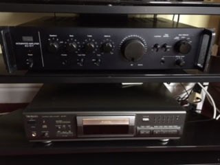

Actually, they are growing on me! They are the only area of the amp to have been marked or scratched though, so if they are to stay, I will need to repaint them. Anyone have any tips?

For refinishing the steel rack handles I have used a simple standard spaycan with satin black (the ones for black car wheels are often spot on) with great result. Important as with all paint jobs is the preparation: Degreesing and (only if needed) carefully sanding some dammaged/scratched areas. Oh, and demount the handles from the amp first :rolleyes:
Sometimes I used a grounding/filling spray first (this also gives a bit of a rough surface finish that adds to the original look after spray painting satin black).
With this, I assume you have steel rack handles (there are also plastic ones, provided with the mk2 versions and items introduced in 1979 and upwards).
Have fun
-John-
Be aware that these AU-series (117-717) often need a good cleaning of all switches (a clue is intermitting sound or no sound at all from one ore both channels, that changes while working switches and pots).
Have fun
-John-
Thanks, John. Yes, metal possibly alloy handles, I haven't taken them off yet but the weight will tell... and yes you were right, after many hours listening I can tell the pots and switches do need a clean, left channel occasionally a little scratchy, connected with the speaker selector I think. It will go for service soon as my Trio comes back.
So what year is this, assuming it's a mk1 (and how do I tell? Is it a case of if it doesn't say mk2 it's a mk1?)
is there a serial number sticker on the back of the unit? if so, the third digit of the serial number is the last digit of the year it was produced. so, for example, if it’s an 8 then it was manufactured in 1978. if it’s a 1 it was manufactured in 1981 and so on.
.. So what year is this, assuming it's a mk1 (and how do I tell? Is it a case of if it doesn't say mk2 it's a mk1?)..
You have the original AU-317 (yes, if it doesn't say Mk2 it's a Mk1).
The mk2 has a different (white screened) logo on the front and the suffix MkII on front and rear. FYI Sansui only seldom made a mk2 product, problably the AU-117/217/317 are the only ones who had a prolonged lifespann by introducing an mk2 version.
This is correct, your AU-317 probably has an 7,8 or maybe 9 as third digid, stating it was produced in 1977, 1978 or 1979.
I think the original AU-317 was introduced in 1977 and the most were produced/sold in 1978.
The Mk2 was probably introduced in 1979 and mostly produced/sold in 1980.

I do have one observation: The 317 volume control is quite 'sharp', i.e it goes from zero to 'significantly on' in one step. It's not a problem, it is still low enough for use, but it is a considerable increase in the first step. Is that normal?
I was always told THE LAST THING YOU SHOULD DO is power up an amp without connecting the output stage to speakers.
Actually that's the correct advice for a Valve amplifier, but the opposite is true for a SS amplifier. ;)
This can be the case if the input level to the amplifier - from a CD player for example, is a bit high. The input sensitivity for Sansui Tuner and AUX (or CD) inputs is often 150mV, whereas CD players without an output level control (common) can output up to 2V. This can give the effect you describe, where you are using the amplifier volume control as an attenuator to remove some of that excess input. It is however 'normal', and even if it happens when using the Phono input & turntable, providing you still have sufficient control of the volume there is nothing to worry about. Some amplifiers (like AU-717) have a front panel -20db switch which can be used to give the volume control a more usable adjustment range.
I have experienced this effect with my own CD player (which has no output level control), the simplest solution, and what I use is 'in-line RCA attenuators', 10 or 20db will make a useful difference. ;)

With regards to the stepped-volume pot from zero to 'significantly on' in one step - this is normal for this amp (and other amps in this series) - On the amps that have the Muting switch, it is possible to have a little finer control at lower volume levels
