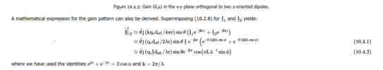

Perhaps if I ever saw a dipole array in real life and not just diagrams or distant pictures I could create something from common sense. I can't even get past step one as I don't know if I need a flat top configuration, or an inverted V configuration or a sloper configuration or the pros and cons of each. And everytime I start to read about how to design a dipole antenna I come across dipole directions like this:
Clickety click
It is called a collinear array. It is a successful and easy way of creating that disc-shaped radiation pattern that you need. If you use four folded dipoles and connect them in parallel using 300 ohm twin lead you end up with 75 ohm symmetrical that you can connect to a 75 ohm cable using a balun or 1:1 transformer. And there are many more techniques.
