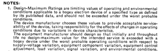

40ma at 350 volts is 14 watts plate+screen. A little hotter than I'd prefer to see, though technically within the design max rating of 13.2+2.2 or 15.4 watts.
but yeah a lot of the rating difference in a 7189 vs a 6bq5 is just the rating system involved. Design center v design max. I have seen a 7189 sheet in design center which is what most of the 6bq5 sheets are and the numbers are the same except for the plate voltage. 400 vs 300. If you look at the design max 7189 numbers they allow for 440 volts. Basically design max is 10% over the design center numbers.

Mullard lists the "limiting values" of the EL84 as 12W/2W, anode and screen. Sylvania shows the maximum for the 7189 as 13.2W/2.2W. That's 10% greater dissipation, for whatever it's worth.
