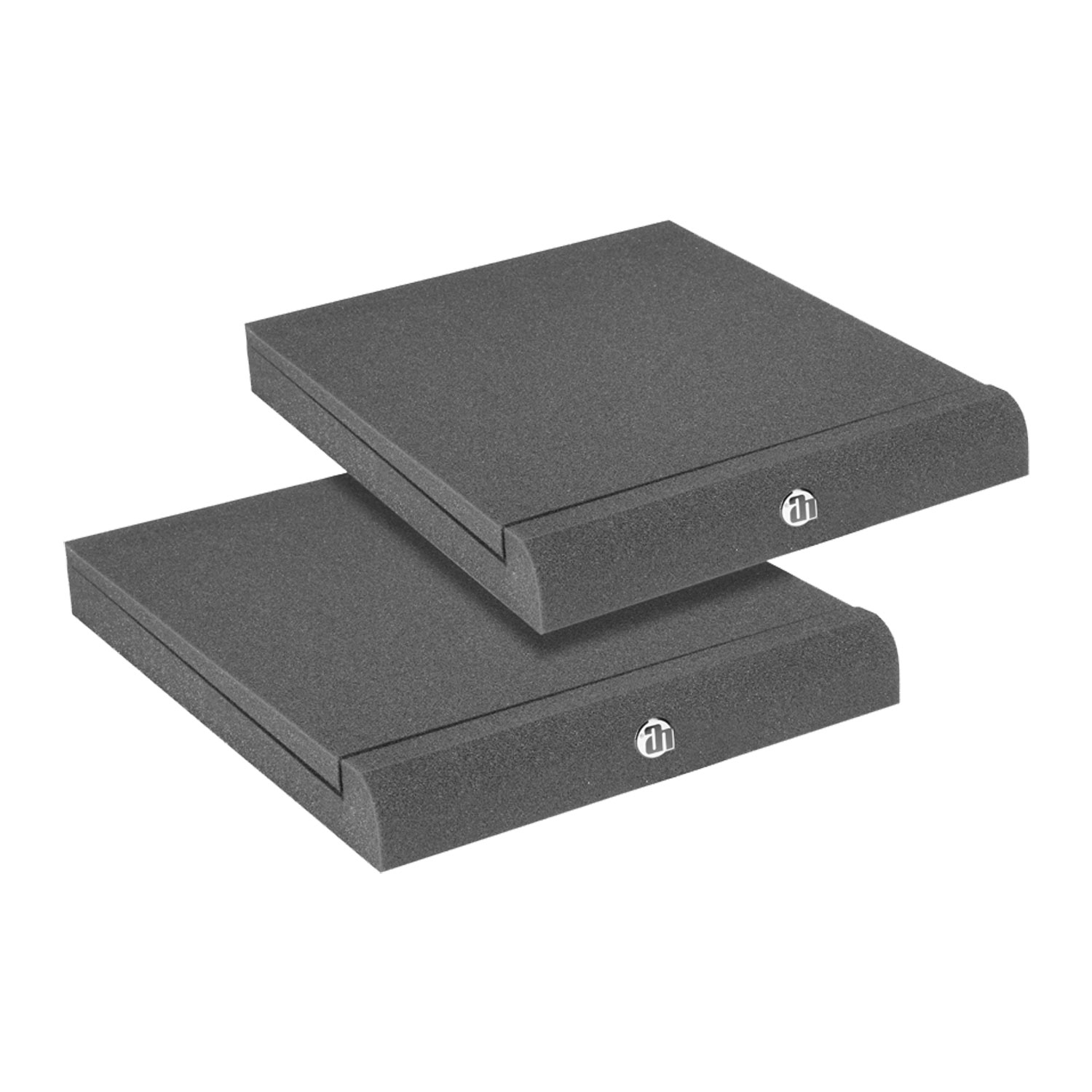

In my opinion stands won't help. However, isolating the speakers from the surface they're sitting on will help. Something like these will reduce the tendency of the credenza to vibrate.

But since your little KEF seems to be a Wide-Band or a Coaxial speaker, this slanting test could be inconclusive... Then the idea of @rothwellaudio is interesting, since it will isolate your speaker from your turntable, since they share the same stand surface, which could cause transmission of vibrations :

I should have mentioned that the main problem with your current setup is that vibrations from the speakers will be directly coupled through the wooden top they're sitting on to the turntable. Breaking that path of vibration transmission is more important that raising the height of the speakers. Something soft/compliant will do that whereas something rigid won't.
Vibrapods, or similar, would be another option.
Thanks for the advice here! My setup was ever evolving but I’m finally content for the most part. Maybe a speaker upgrade down the line. But was curious if them resting on the wood would impact the turntable. I opted for these ISO Acoustic Puck Minis. Super excited to see if they enhance the sound
