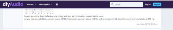

I found a seller of a Bose AM-5 series 1 subwoofer/satellite speaker set that I’m interested in buying. I’m not a Bose fan by any means. The only reason I’m interested in buying the three piece set is so I can use the bass module in the trunk of my car(1999 Honda Civic coupe) to add some extra bass. I’m currently using a pair of 6-1/2” coaxial door speakers powered by a 50Wx2 amplifier and was considering connecting the coaxials to the bass module outputs. Does anyone know what the crossover frequency is on the bass module outputs? Not much information online about the AM-5 series 1.

Thanks. I already read that yesterday.
I ask a simple question that the answer to should be a fact and all I get is opinions. All I asked was “Does anyone know what the crossover frequency is on the bass module outputs?”
i was just trying to help you out. i stated that i had heard them before.
but i thought that the link i provided, which you said that you read,. answered the question.
so, my guess is the xover is about 210hz.
I appreciate you trying to help. The article explains how to improve the response of the satellites but it doesn’t state what the high pass output of the bass module is. It shows a frequency response graph but apparently that is the system as a whole. I don’t see a dip centered at 210Hz as stated. All I see is the one at 2500Hz. I think around 200Hz would be my guess too. I was just wondering if maybe it was closer to 100Hz.

200-250 as stated. Have fun.
Since you aren't going to believe what people tell you, why ask? You won't believe this, but the low pass crossover isn't anywhere near 100Hz. Bose tunes the crossover to result in a real frequency near 210Hz, +/- 3dB. It's tuned to try to match the frequency response (approx 280-13500Hz) of their useless cube speakers.
