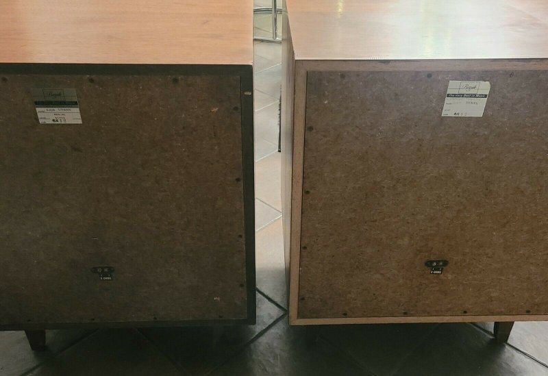

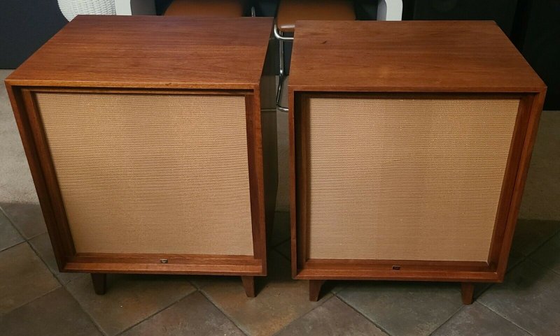

Hi All,
So I've seen a set of speakers that I like the design the buy a brand called Bozark, and have attached a few pictures they're very mid-century in design, now I was looking at recreating set speaker design I I fabricating the box is myself!
But the thing I'm stuck on is do I go 2-way or 3-way in driver design?
I'd be looking at going for all cone drivers, but not sure if there's any benefit to having the tweet, mid and woofer or just mid and full range woofer insted?

the tag on the back of the right cabinet does appear to be the Bozak label,
like this other one I found ...

Are those 302's ?
Not a clue to be honest I was scrolling through vintage speakers on eBay and I do have a thing for the mid-century style very similar to that I have a few pieces of mid century furniture currently in my flat so I was looking for something to match the aesthetic but for the price of what they're after on eBay I can't justify it where I could realistically justify half the cost to build my own I'll build them over time

If you simply desire the mid-century appearance, that's one issue.
If you want an actual Bozak, well, that's a whole can of worms. Bozak uses infinite baffle design, which requires an internal lining of cotton and a hanging curtain. You will likely spend as much recreating the cabinet and curtain as you would buying a pair on Craigslist.
