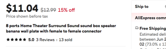

For the RCA inputs and speaker outputs I'm using a wall plate that's typically used for home theater installations. There are a couple different types of these. Some plates have small square holes and use connectors that snap into place. I'm using the type that has the speaker binding posts and RCA jacks fastened to the wall plate with nuts. Either type should work fine.
You'll usually find these plates with either all speaker connections or all RCA already installed. The one here originally had 8 speaker connections. I removed 4 of them and filled two of the empty holes with RCA jacks that were removed from some of the square snap-in types. So now I've got 4 speaker connections and 2 RCAs mounted onto a single plate. The RCA jacks are female to female.
The 8 position terminal strip diagram that I posted earlier shows how the RCA inputs are wired.
You could use a plate that has 6 connections instead of 8. I bought the 8 connection plate so that I would have 4 extra speaker connectors that I could use later for other projects.
If you want to build it like I have here (without solder) you want to make sure that the connectors themselves do not require solder. Some listings for these only show the outside connections and you can't tell if the inside connections require solder or not. You need to be able to see pics that show both sides of the connectors so you can confirm that they're the right type.
For the speaker connections I'm using banana plugs on speaker side. They also use screws to attach the speaker wires. On the amp side of the wall plate the bare wires from the OT (output transformer) are screwed into the binding posts.

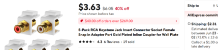

Here's a pic of the speaker posts that are used in the wall plates and the handy RCA plugs with screw connectors that I'm using on the amp side of the wall plate.
This is just one method of making these connections. You don't need to use one of these wall plates. For example, the OT (output transformer) secondary wires and the speaker wires could be connected with screws using one of the same type of terminal strips that are used elsewhere. Vintage amps typically use screw terminals to connect the speakers.
For the RCA inputs you could just cut an interconnect cable and use the screw connections / terminal strips on the wire end. The end that still has a plug can either be left long enough to connect to a source or it could be kept very short. If kept short you could then use a female to female RCA adapter to connect separate / longer cables.

Here are pics of the OT listing and some of the other items that were purchased from places like eBay and AliExpress. The descriptions can be used to search. These are not links and prices shown may not be current or the best deal. The sellers are not identified. Sellers come and go and deals change so all I can say is "shop around". Buy from whatever source you're comfortable with.
