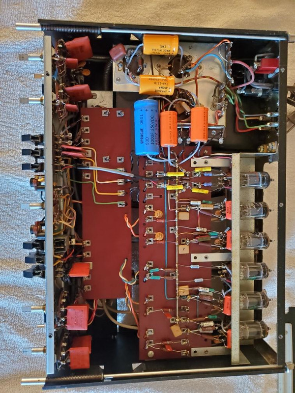

There's one not far from me that has become available. Definitely don't need it. Very much like my C34V in my current rig. That said, it's a C22 in beautiful shape, and it had at least some restoration in the mid 90's. So I'm intrigued. I have no knowledge of electrical restoration, so when folks look at these pictures I would appreciate thoughts on them, and anything else that I might want to focus on when I have the chance to give it a run though.

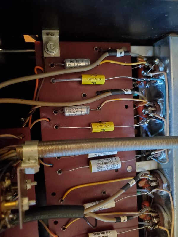

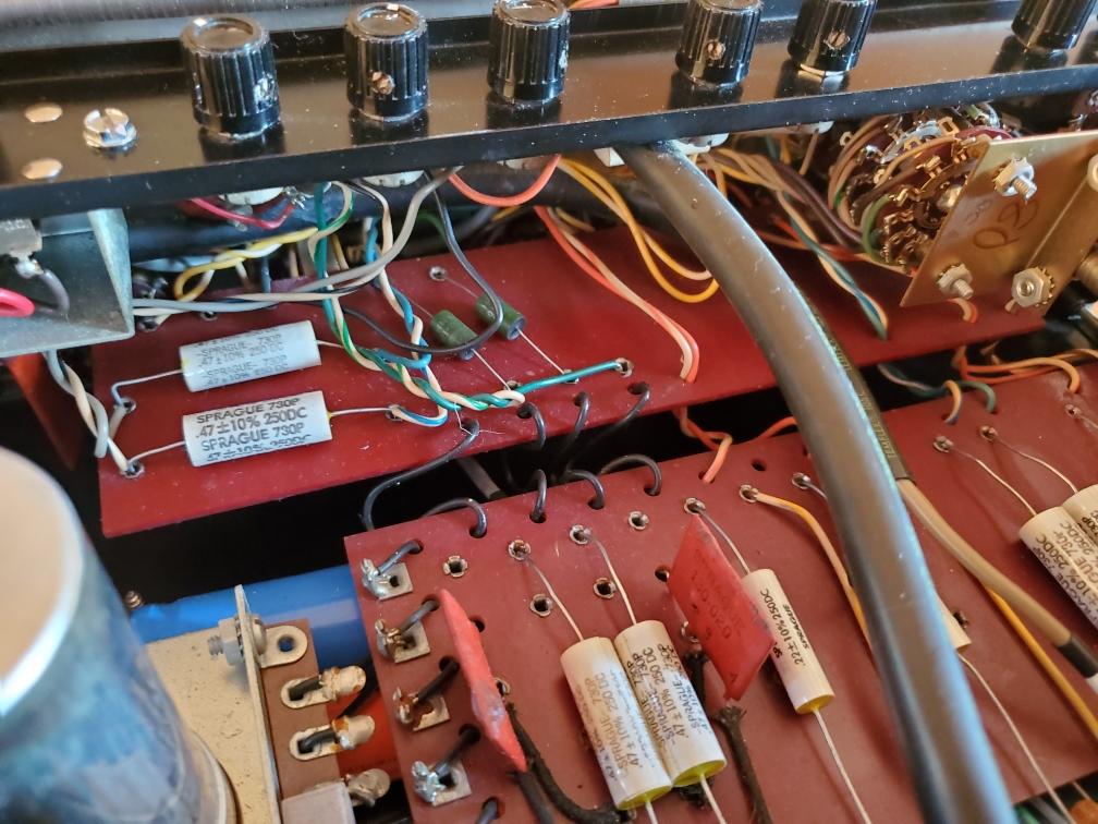

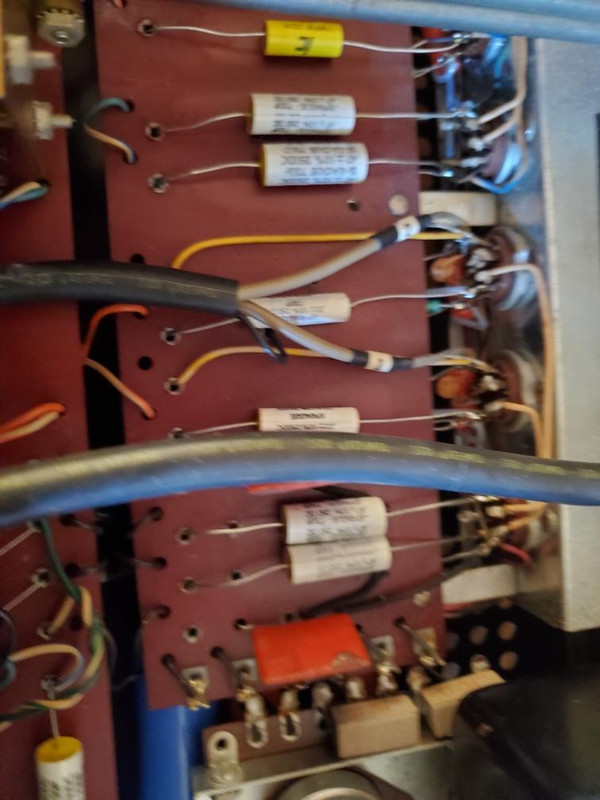

Mostly I wanted to put the pictures up to better understand if it looks like it's in good electrical shape, or will need help sooner rather then later.
It looks fully recqpped. I think the date codes on the electrolytic caps show they were made 2001. The tubes are teles which are about the best there is. If you can try it out, do it. You may well love it.

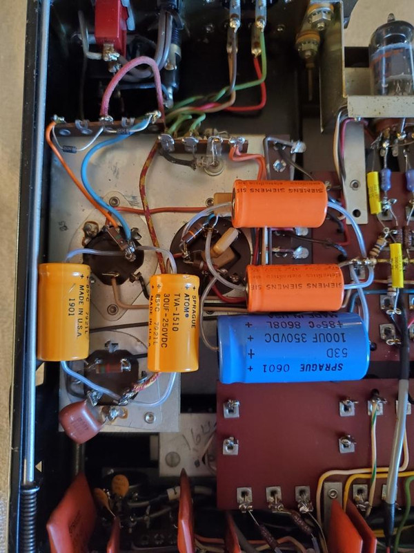

Sprague Atom even make the TVA yellow nowadays? And the Siemens may be older as well. Nothing a new can or newer lytics would cure.

Can you examine the top side of this to look at the three aluminum can capacitors? See if they have any labels on them to indicate they are newer than 1960s? My only hesitation is that it looks like those blue and orange capacitors were paralleled onto the old can caps to make up for bad sections of what might be the original cans. If that is the case you definitely want to put in at least the three new can caps.

Pretty hard to evaluate the electrical condition with just pictures of the circuits. Maybe you can take it to a local tech and pay them to test and evaluate (with no plan to have them work on it otherwise) to see if it's making specs for noise, distortion, output level, RIAA accuracy, etc. - like getting a PPI for a used car.
Yeah, I was going to comment that those non original axial electrolytic caps look to be simply tacked on the original chassis can caps, that are still connected and in use in the power supply..
When I zoomed the pics of that area, it appeared that the can caps look original and that somebody just tried to inexpensively/lazily boost the lowering of their mfd. with age by tacking in those new caps..
It`s quite possible that the can caps are also running warm because of the increased internal leakage brought on by the breakdown/drying out of the electrolyte which is not good for the power transformer by stressing it.
I recommend that situation be looked into and addressed.

Remember you're talking to an electronics infant. Which one's are the can caps?
Oh, the blue and orange one's?
