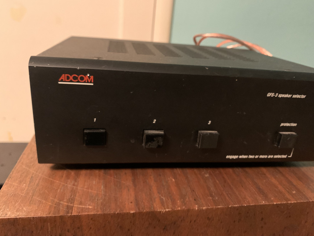

Hi Guys,
Looking for a bit of advice regarding connecting a 3rd pair of speakers to my MC-2300.
As of now I have a pair of JBL 4312's and 4313b's which are connected to the back as you can see in the photo below. I guess that years back I combined both pairs of speakers into their own sets of banana plugs to place into the COM and 4ohm spots. (I can't even remember doing that!)
I am adding in the speaker cabinet below which has two speakers in it. They are likely JBL D-120 or JBL E-120 which should both be 12 inches and 8ohm's.
My question is what is the best way to connect these to the MC-2300 while still retaining the other two pairs? Can I keep the wires separate or do I need to combine them into the same banana plugs as these? Would prefer to keep them separate if possible, but of course would not want to have any sound degradation. I'm not very savvy at this sort of stuff so just want to make sure I don't fry anything.
Thank you!
Is there some reason you don't want to use a speaker switch box? That's what I do with my 2300 for connecting 2 and 3 pairs of speakers to it. No degradation of sound that I can tell, and don't have to worry about shorting anything.
Thanks and I could be open to that. Which speaker switch box do you use with the 2300?
A Pyle 4 zone speaker selector. Cost about $30.
So after I posted that I took a look at my box and it turns out it's an old Adcom that I picked up somewhere. Probably could get one of these used for less then a new one from Amazon, but I'm guessing they're all pretty much the same and get the job done. Plus, you can always turn off one or 2 sets if you want to just listen to one pair.
