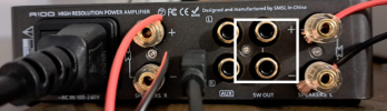

Hi swechsler, homebrew & AK folks, just to update and come back on this: I got the S.M.S.L. A100 and its working well :rockon:
I connected the USB from laptop to amp, and speakers from amp to subwoofer, as instructed above (still need to snip off the excess speak wire - just want to get it up & running first :cool:). This gave me sound to the 2 small speakers, but no sound coming from subwoofer. So I connected an RCA cable from the amp SW OUT ports to the Subwoofer LINE IN ports (see below), and am now getting sound to the subwoofer too...is this the correct way to connect it for subwoofer sound to come through as well?

You need to run the speaker wire to the "From Receiver" binding posts for speaker wire input to the sub amp.
If you keep the RCA cables going to the subwoofer inputs you can disconnect the speaker wire going to the sub amp.
I would use one or the other (RCA or speaker wire) for input to the sub amp, but not both.
Thanks opnly bafld, sorry yes I have connected the speaker wire from the amp to the "From Receiver" binding posts. See below photo of subwoofer setup now. I tried disconnecting the speaker wire and only using the RCA cable, but that cuts the sound to the speakers. So seems they are acting independently - the speaker wire is providing sound to the speakers and the RCA cable is providing sound to the subwoofer. Is that right?
If you want to continue using the RCA cables to the subwoofer you don't need to run speaker wire to it.
Just run speaker wire from the SMSL amplifier directly to the speakers.
You can disconnect the RCA's in the picture above if you keep the speaker wires connected.
Either way will work.
I will try that in the morning so...running the speaker wire directly from the amp to the speakers
But when I disconnect the RCA cable, there is zero sound from the sub woofer, no bass at all.
Yes
Speaker wire from stereo amp to sub amp speaker wire input "from receiver" ?
The subwoofer amplifier needs a signal from the stereo amplifier, does not matter if it is RCA cables or speaker wire.
The subwoofer has both inputs so the user can choose which one to use.

Yes, that's the way I had it connected, but there was no subwoofer sound until RCA cable connected

Thanks for this. I have connected the speaker wire directly from the A100 amp to the speakers and they are working fine. RCA connected from the A100 amp to the subwoofer LINE IN ports, and subwoofer working fine too. So all good - see photos below of how it is set up now.
So just wondering why the subwoofer doesn't work when I connect the speakers wires using the FROM RECEIVER/TO SPEAKERS ports on the subwoofer, without needing to use RCA cable?

Class d amplifier might need just the red wires and one black or no black wires connected to the sub input. :dunno:
The Pioneer subwoofer pictured has a switch to select line or speaker in, but that is very rare.
Obviously with it you would need to change the switch setting or it would not work.

Its strange alright. There's no switch like that on the back of my Canton subwoofer. But at least its all working fine now anyway, with sound coming from both speakers and sub. I don't even have the amplifier turned up to a quarter of the level and its very loud, sounds good.
Now just need to experiment and find the best setting for the crossover 50 Hz - 150 Hz and phase 0 or 180 degrees :)
Glad you got it working; I am mystified as to why the speaker level inputs don't work on the subwoofer. Since you purchased them secondhand, it's possible that the previous owner modified the subwoofer. I wouldn't worry about it.
