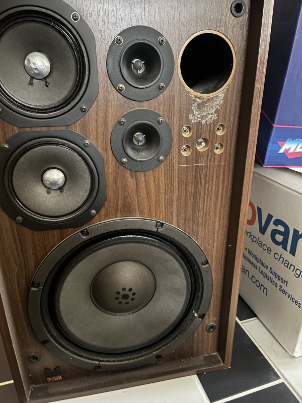

Does anyone know where the capacitors are mounted inside vintage Sansui speakers, specifically SP-2500X’s? I’ve done the DOT-3 trick with the surrounds and at this point I think the last thing they need would be new caps. Changing them doesn’t look too hard but knowing where they are in the speaker box would be good before I start pulling out the tweeters, midranges, woofer.
Crossover in SP-2500X should be under the port hole. The Sound Balance control rotary switch is part of the actual assembly.

Looks like everything is on a little shelf behind the sound balance selector but no idea how to open these suckers up to access it. They don’t have the back plate with visible screws like the 2500’s do.
I can see the caps but can’t figure out how to easily access them. Looks like 4 caps per speaker.

Four threaded studs protruding through front of the assembly:
Very light impressions in back of control plate:
Looks like there are four nuts under the control plate, threaded down into the front baffle just below the surface.
Which means the plate needs to come off (VERY carefully) to get the crossover out.

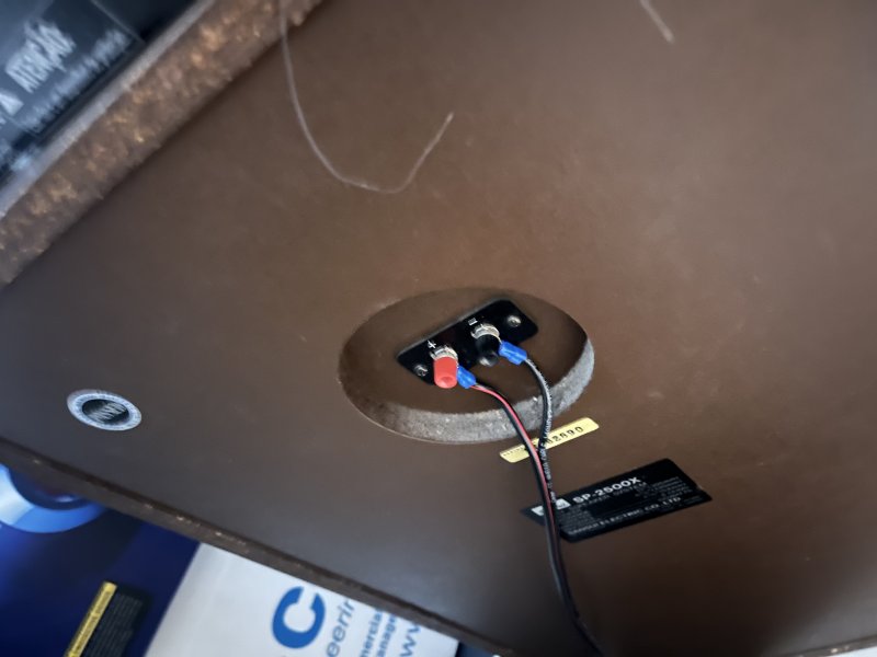

Hopefully not resurrecting an old thread, but how do you actually open the back of the cabinet? I'm able to access the nuts on the 4 studs mentioned above, but not sure how to access the shelf once I take off the nuts.
Once you take the nuts and knob off tug on the shelf. It should come loose. If yours is stuck it may just be from years of the wood to wood contact. Mine fell right off as soon as the nuts were out.
Sorry, but how do I even access the shelf? The only two screws I see are on the wire terminal plate...
The shelf is attached to the front of the speaker cabinet to the right of the tweeters. You have to remove the crossover sound selector knob and the metal name plate around it to access the 4 nuts holding the shelf to the cabinet.
I was able to remove the metal plate and I see the 5 nuts. But as it stands right now, I'm unsure of how to actually grab the shelf once those nuts are off. Should I just remove the big lower speaker and grab it that way?
The nut in the middle stays in. That’s attached to the shelf not the cabinet. I put the speaker on it back and removed the 4 nuts. When the last one was removed the shelf drops literally a few inches onto the 1”thick felt on the back wall of the speaker. The whole cabinet except for the front face plate is lined with that felt so nothing will get damaged.
Another thing, remove the bolts from all the speakers - woofer, tweeters and midranges. Pull them out and disconnect the speaker wires from the terminals. This will make it easier to take the shelf out and work on it. I think the only wires I didn’t remove from the shelf was the power feeds from the terminals on the back of the speaker to the shelf. Also when replacing the caps I found it way to easier to get a good pair of dikes and snip the leads on the caps themselves rather than unsoldering the leads from the terminals and solder points. Then rough in the new caps and shorten their leads to solder them in.
