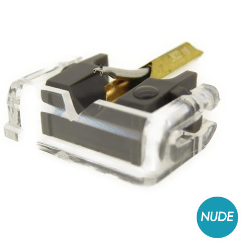

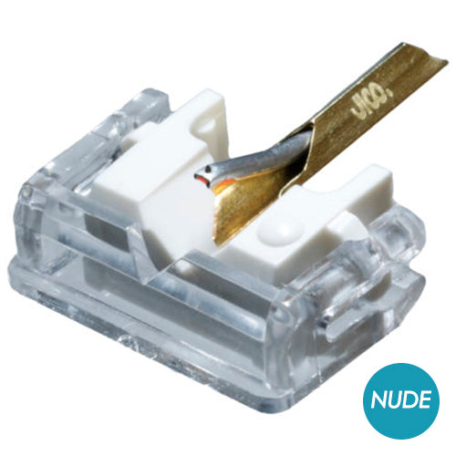

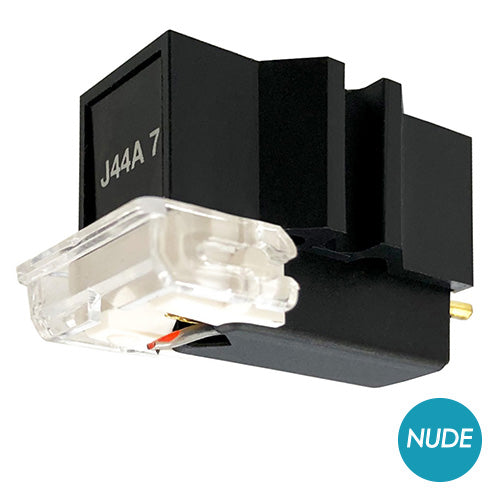

I have four Technics direct-drive turntables now, SL-1300, SL-1400, SL-1600, SL-1800. I've used about a dozen or more different cartridges in them and found they sound best when using my collection of Shure M44 cartridges, especially with rock music and Jazz.
The Technics direct drives all seem to need a little more bass boost that the M44 has. Lower powered amplifiers, like your HK330C, benefit from the higher output of the M44 series as well. Shure discontinued them but since they were manufactured from the 1960's thru 2018, there are plenty on the used market and many NOS. I now use JICO after-market styli for them, they are an improvement over the later "Made in Mexico" originals that could sound a little harsh.
In addition to replacement styli, JICO has also cloned the M44 cartridge body to meet the demand.
