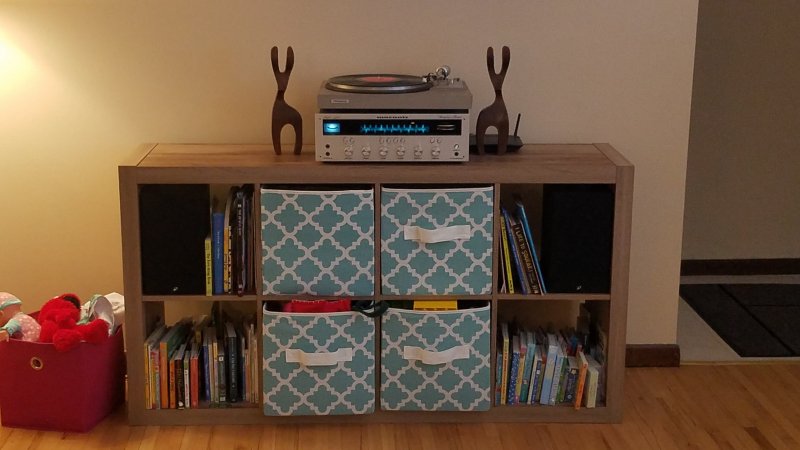

Is there a size limitation?

I would definitely go for sealed or front-ported speakers if you're limited to putting speakers inside that bookshelf (it looks like that's where your B652 speakers are located). If you can put a pair of speakers on top of the shelf, and pulled away from the wall a bit, rear ported should work fine. In that case, I would suggest taking a look at the Sony Core SSCS5, which sometimes go on sale for less than $100 new. There are many other options out there.
However, if this were my setup, I would opt for narrow tower or standmount speakers to place on either side of the bookcase. That way you get better stereo separation and the tweeters are at a more appropriate height (you generally want tweeters at ear height at your usual listening position). For example, Pioneer FS52 towers occasionally go on sale for $129 per pair from Amazon. Polk also sells some decent towers that sometimes go on sale for less than $100 per pair (at least they did over the holidays). That said, I know how wives can be and how floor space can be a premium. Good luck!
Awesome suggestions. I put the Daytons back up on the top shelf again where they should be. Forgot how much clarity I lost by putting them down low. Might be fun to try the towers... wife permitting. I was just looking at those Sony Core SSCS5s. Looks like there is at least one pair on Ebay for $100. I'm sure this is already like 100 places in other spots in Audio Karma. Sony Cores vs Pioneer BS22. Which comes out on top?
