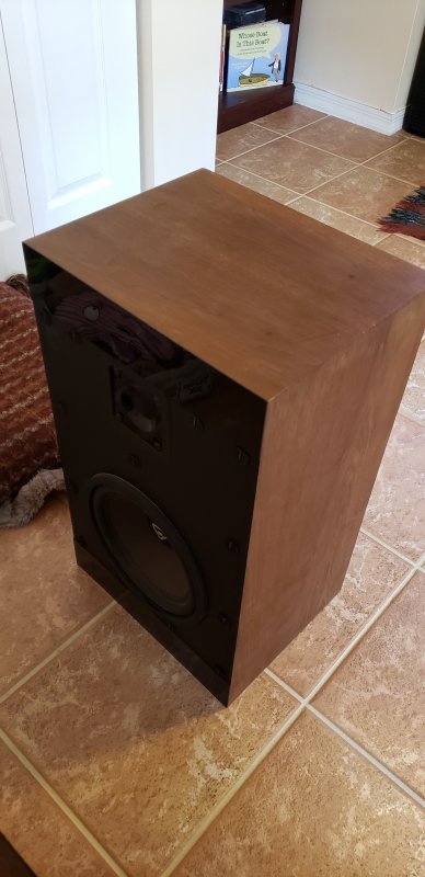

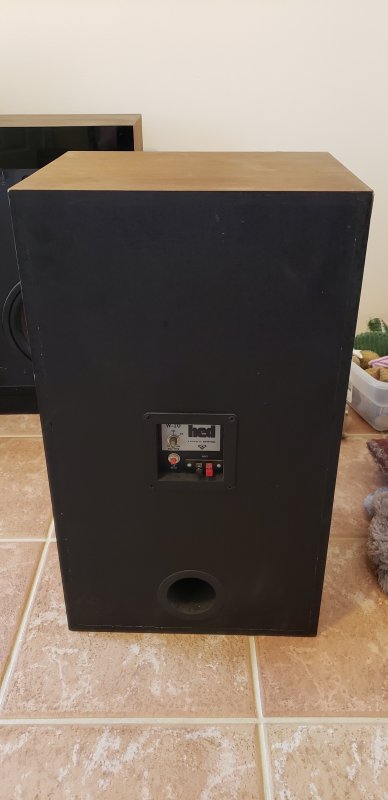

I just purchased a pair of HED W-10's for $50 Here are some photos. These are very heavy. I have not opened them up or tested them yet. Supposedly they came out of a multi-million dollar home here in S. Florida. They had been in a closet for 20 years. I'm waiting on my receiver to be delivered that I purchased off Ebay.
I had a pair of those bought new in '79 and loved them. I stupidly got rid of them in the late 90's much to my regret. Enjoy!
