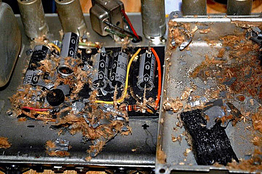

Even in amps that had miswired main power supply caps and blew up, the PT was okay. Schumacher and Triad did make hearty irons.
The PT was okay, believe it or not.
