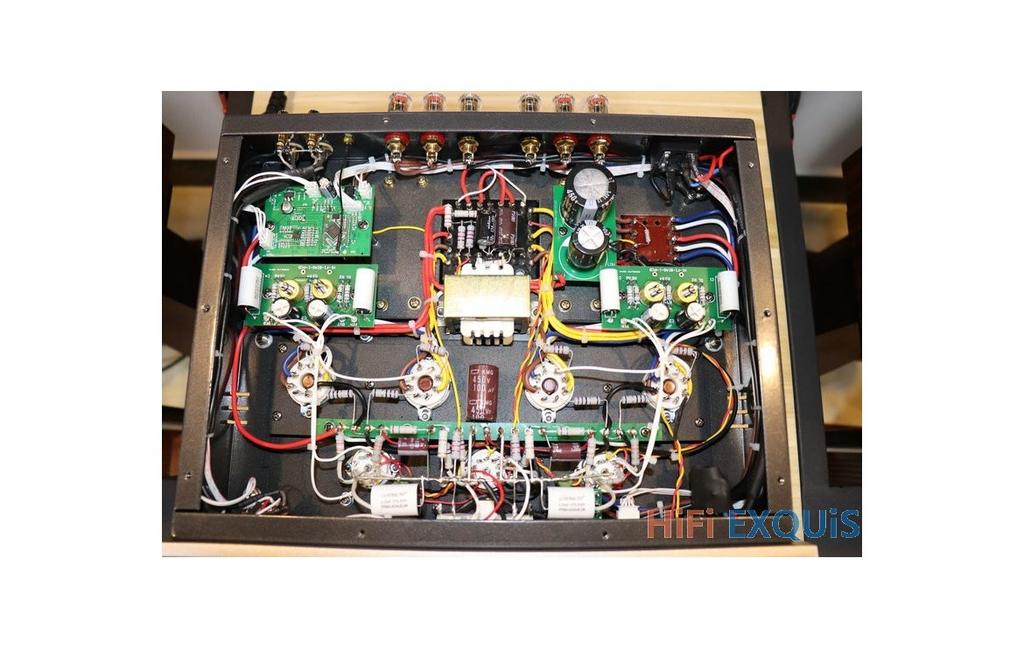

I'm watching on the bay a 35W, EL34 powered, integrated amp which seems interesting. Point to point construction and attractive aluminum chassis. It's branded Rftlys model A1-EL34. There's also a more expensive variant with KT88. Never heard of the brand before. Have you ever had any experience with this brand/electronics? Your opinion about the specific model posted would be appreciated, as well as any suggestion regarding alternatives. Thanks for your attention!
It looks like a nicely built amp. Good size transformers. I would try to get a service schematic in case it goes south. Looks like it uses fixed cathode bias rather than adjustable grid bias. Fixed bias is OK but grid bias is preferred.
@Rog Beltmann Thank you. Referring to the fixed bias, I can see four pots mounted over two small pcbs by the main tube sockets inside the case. Are those bias trimmers maybe?
Yes. Those sound like the grid bias pots. If they are should only need adjustment when changing tubes. The owners manual should cover it if they are a user adjustment otherwise i'd leave em alone. My amp uses 4 tiny LED lamps. When the bias on each tube is adjusted correctly the lamp for that tube goes out. If your amp uses fixed bias there should be a fairly good size 230- 250 ohm resistor going from the cathode (pin 8 of the tube socket) to ground. If it uses grid bias pin 8 will go straight to ground.

Thanks. I've seen a macro of those pcbs. The bias points are clearly printed over them. I guess you only need to insert the probes of your multimeter in the holes and read the value of the voltage.

Nice to see its mostly point to point wiring. Looks like a very well thought out design.
Even though there is a lot of point to point wiring, good luck finding a replacement if one of the boards has a problem. Not necessarily a deal breaker but it's something to consider. Of course, this holds true for pretty much any product that uses circuit boards. The unavailability of replacement boards, even for stuff made fairly recently, results in many products ending up in the scrap heap. All point to point is really the way to go.

This amp does look to be a considerable step up from the cheaper Chinese offerings.
That said, it's difficult to even find a schematic for most Chinese amps much less factory replacement parts. Maybe this company is different and has replacement boards for sale. You might want to ask before you buy. It would be a lot easier to have a replacement board sent to you than to have to return the amp to China for repair, assuming that the factory even has a service department, which is very unlikely.
