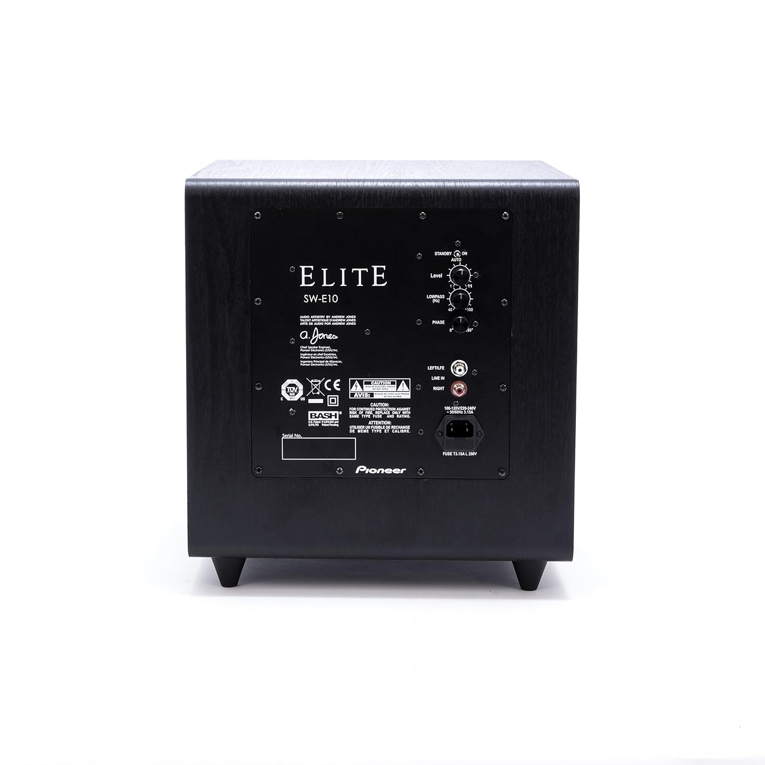

Generic SW photo:

Generic SW photo:
thats a quality looking sub is it new? We're did you buy it .
Pioneer elite make subs now?
I thought to it was just receivers they made.:beerchug: Epic
It's Polk Audio. Maybe someone else posted that pic just to show me.
