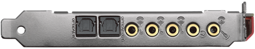

I’m not sure where the Wiim will get plugged in as I have no available ports on my hifi setup as everything is taken up on the back of my preamp with my turntable, tuner, amp, R2R and cassette deck. I’ll show you a diagram that came with the system back in the day, along with a photo of the back of my system with nothing plugged in. Note, in the diagram it doesn’t show anything plugged into the AUX on the back of the preamp, but that has my cassette deck plugged into it for playback only.

Treat your PC like any other source, i.e., CD player, tape player, turntable, etc. and connect the analog audio "out" of the PC to the aux "in" of your amp or receiver.
It could be as simple as that but without seeing your setup, we are just guessing
It would save us all a lot of time if you would simply post photos of your gear, (stereo & computer) front and back
Does that mean when I listen to anything on my PC I just make sure my hifi is turned on? If so, that’s easily done.
Yes, I did do that previously. I’ll attach them again for you, I’ll attach the diagram that came with my system back in the day, my system with nothing plugged in, and the rear of my PC’s sound card; thanks for the ply.

I can easily connect the PC to a RCA switch box that I’ll buy with a 3.5mm stereo-to-RCA cable that you mentioned in a previous post.
