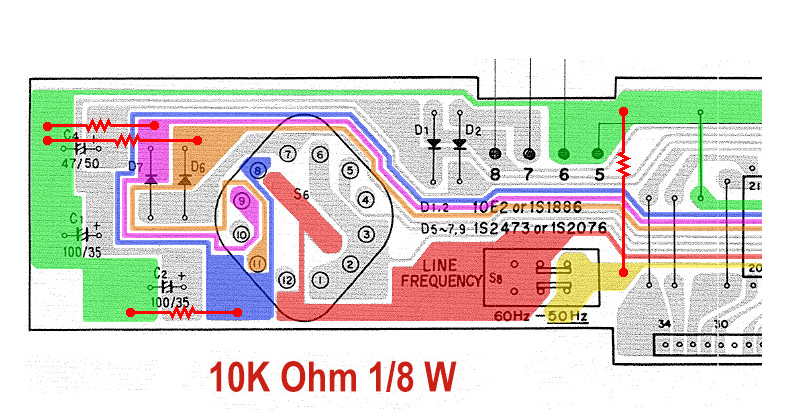

The following instructions describe how to solve display instability (mode flicker) and clock speed accuracy problems that can occur with Pioneer DT series timers. These problems are due to failing internal resistors of the MN6076 clock chip. The solution is to add four 10K Ohm 1/8 Watt external resistors to the mode select and line frequency select inputs.
All 4 resistors have one end tied together, and then tied to pin 27 of the chip. Then, the other end of the resistors are to be tied, individually, to the following pins: 29, 30, 31, and 36. That should solve most issues with these units.
Alternatively, the 4 resistors can be installed on the PC board at locations where they can be easily mounted. The attached diagrams illustrates this method. The red trace is Vss and the green is Vdd (pin 27). The blue, purple, and orange traces are the 3 mode select inputs (pins 29, 30, & 31). The yellow trace is the line frequency select input (pin 36). The new external resistors are shown in bright red.

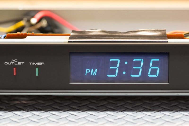

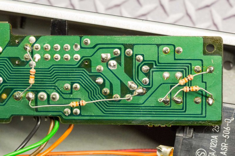

I made the modifications to my DT-510. It took me less than 2 hours. My unit had deteriorated to the point where the flickering had stopped and it it was permanently stuck on 12:00 am. I connected the resistors based on easy of installation. I didn't want to drill holes in the PC board and I was afraid to connect the resistors directly to the clock chip pins. So, I connected the resistors to existing components with long leads. And now, my DT-510 works again! Thanks @pustelniakr! I would have never figured this out on my own.

Thank you! Implementing the bottom configuration solved the clock instability problems. I was going to throw my DT-500 in the trash but my wife told me to try one more time! It worked!

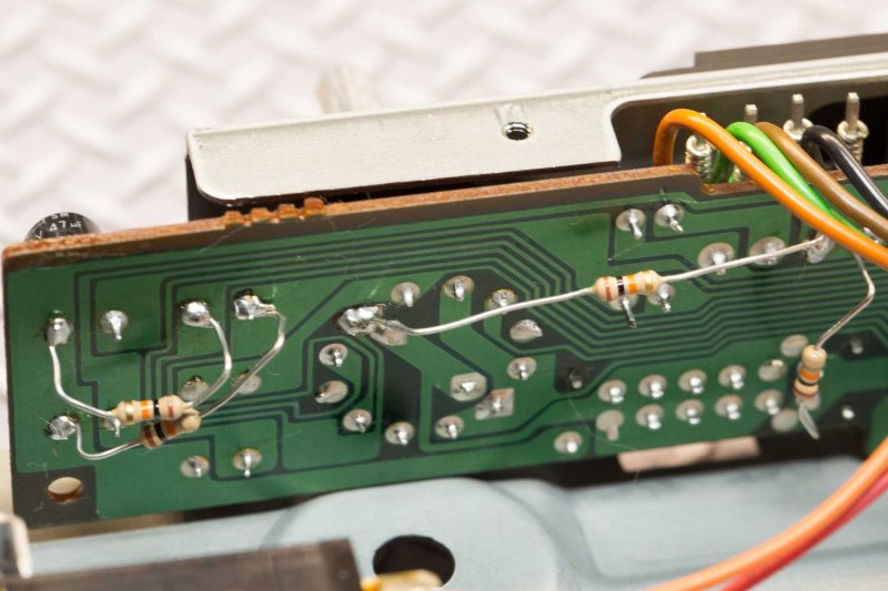

This six year old post saved my DT-500 from the closet (I rarely throw even defective equipment away)! I want to be the next person to say thank you! I was abler to add a single resister as shown to fix my flicker issue. Mine would flicker when "Clock" was selected, between the clock and the minutes/seconds. After about five seconds, it would stay on the minutes/seconds. Since the bodge, I've left the unit running for 30 minutes and it appears rock solid.
I picked this unit up at Goosdwill. After taking it apart to troubleshoot, I noticed a darkened (from heat) area in the upper right hand corner of the VFD, though I don't know if that's normal. I've confirmed the voltage going to the tube is correct. I'll keep an eye on it.
Thanks again 1Mike161, for your original post!

I just learned the hard way one cannot simply replace the chip for a new one, as it is permanently attached to the clock display, all those solder connections, ugh! On the upside: I got lots of desoldering/ soldering practice, and practice with getting all those 'legs' back into place. at least it's back together and working as it was :10 minutes fast per hour, now for the resistor fix... and 2 hrs and two trips to the hardware store ...works like a charm, down to the second! thanks Audiokarma community and Dr Strangelove aka 1mike161.
