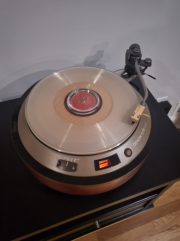

I’m a “flying saucer guy”
Is that the DP-3000?
Awesome machine. There's a relationship between those early Denon DD turntables and the TTS-2500/3000, Sony's first DD motor. So much that I wonder who invented it.
To be more concrete, Sony's TTS-2500, Technics SP-10, and Denon DP-5000 came at almost the same time (it seems Sony was the earliest to actually sell a DD turntable in Japan).
Both the Sony and the Denon use a really similar motor: An AC motor where the rotor is a copper cup, driven at 60 (or 50) hertz and using voltage to vary the motor speed. The control system is really similar. They (Sony and Denon) are radically different to Technics' motor and control system etc.
Moreover the DP-5000 introduced the speed measurement via using a magnetic head and a magnetic track imprinted in the platter (see picture). Which is something that Sony would introduce in their next generation of DD turntables!!!
So perhaps there was a collaboration between Sony and Denon, or maybe Denon invented it!
