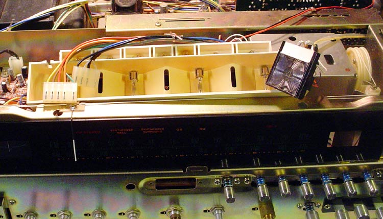

Step 5 - Here's where it gets tricky. There's a secret spot that's hard to describe that allows you to swing the box out for access to the lamps. Best I can say is, work the whole thing to the left a bit and pull it back as far as possible. It will still want to hang on the chassis, but there's one special place where it magically clears and pulls out.
Here you can see the two slip connectors I mentioned, as well as the small circuit board and the 2/4 channel indicator.

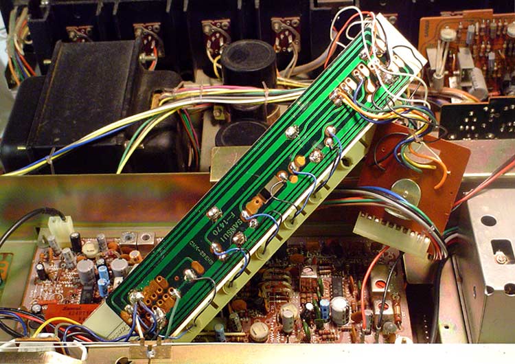

If you're just replacing lamps, that's as far as you need to go, but ... with as much trouble as it was to get this far, might as well go the extra step and resolder the back of the board. If the lamps aren't intermittent now, they will be eventually. With no further disassembly, you can rotate the light box for access to the circuit board. It will fight you a bit, and there's only one way to do it right without stressing the wires, but it can be done. I set the chassis vertical and propped the board away a bit to allow good solder flow to all the connections. That leaves you with this:
I hit each fuse holder with a desoldering tool, and reflowed them with a HOT iron. Lot of bulk on the holders, so you want to heat the tabs first, then slip the iron down to the copper pads. This minimizes any chance of lifting the copper off the board.
I also reflowed all the wiring for the mode indicators. Had a couple that didn't "feel" right, and sure enough, a slight tug broke the connection. Stress during removal of the box I expect. Anyway, good check to make as you go along.
Once done, I swung the box back into place enough to be able to reinstall all the connectors, fired it up and double checked all the lamps, then let it go for a couple hours to make sure the intermittent issues were fixed. Better then than later, right?
